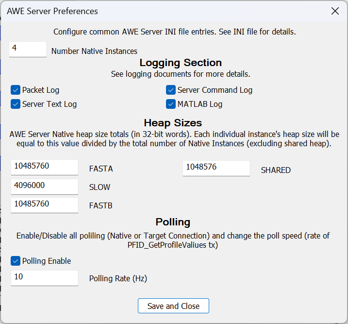

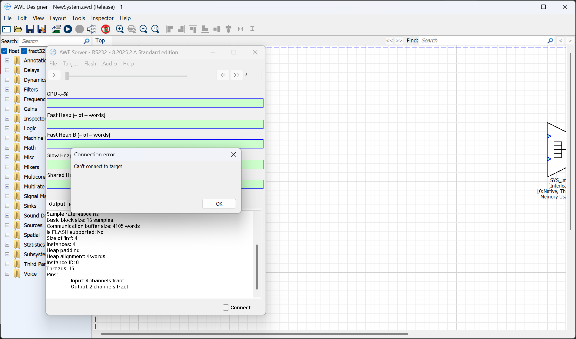

    AWE Connection ErrorI could only enable AWE Server logging as:
     AWE Server Logging
    With this enabled, for the binaries without DiracAwe integrated, which connects to the target successfully, I have the below logs:
    sdk_bin_logs.zip
    while for the binary generated with DiracAwe integrated, I have the below logs:
    diracawe_logs.zip
    As you can see from the packet.log in the above .zip file, we have:
    2025/10/29 09:33:05.208 TX 0002002c 0002002c
    2025/10/29 09:33:05.208 TX-encoded 02 00 AC 80 88 80 80 AC 80 88 80 80 03
    2025/10/29 09:33:05.536 Read failed: Wanted 7 bytes but read 0 bytes, nretries = 0
    2025/10/29 09:33:05.844 Read failed: Wanted 7 bytes but read 0 bytes, nretries = 1
    2025/10/29 09:33:06.147 Read failed: Wanted 7 bytes but read 0 bytes, nretries = 2
    2025/10/29 09:33:06.147 ERROR: Read failed: Could not read the first encoded 7 bytes of the reply, nretires = 0
    2025/10/29 09:33:06.483 Read failed: Wanted 7 bytes but read 0 bytes, nretries = 0
    2025/10/29 09:33:06.785 Read failed: Wanted 7 bytes but read 0 bytes, nretries = 1
    2025/10/29 09:33:07.088 Read failed: Wanted 7 bytes but read 0 bytes, nretries = 2
    2025/10/29 09:33:07.088 ERROR: Read failed: Could not read the first encoded 7 bytes of the reply, nretires = 1
    2025/10/29 09:33:07.422 Read failed: Wanted 7 bytes but read 0 bytes, nretries = 0
    2025/10/29 09:33:07.722 Read failed: Wanted 7 bytes but read 0 bytes, nretries = 1
    2025/10/29 09:33:08.023 Read failed: Wanted 7 bytes but read 0 bytes, nretries = 2
    2025/10/29 09:33:08.023 ERROR: Read failed: Could not read the first encoded 7 bytes of the reply, nretires = 2
    2025/10/29 09:33:08.023 Target IO (awe_FileSystemReset)> 0x673FDC75 - FAILED
    2025/10/29 09:33:08.291 TX 00020029 00020029
    2025/10/29 09:33:08.291 TX-encoded 02 00 A9 80 88 80 80 A9 80 88 80 80 03
    2025/10/29 09:33:08.626 Read failed: Wanted 7 bytes but read 0 bytes, nretries = 0
    2025/10/29 09:33:08.928 Read failed: Wanted 7 bytes but read 0 bytes, nretries = 1
    2025/10/29 09:33:09.231 Read failed: Wanted 7 bytes but read 0 bytes, nretries = 2
    2025/10/29 09:33:09.231 ERROR: Read failed: Could not read the first encoded 7 bytes of the reply, nretires = 0
    2025/10/29 09:33:09.567 Read failed: Wanted 7 bytes but read 0 bytes, nretries = 0
    2025/10/29 09:33:09.870 Read failed: Wanted 7 bytes but read 0 bytes, nretries = 1
    2025/10/29 09:33:10.172 Read failed: Wanted 7 bytes but read 0 bytes, nretries = 2
    2025/10/29 09:33:10.172 ERROR: Read failed: Could not read the first encoded 7 bytes of the reply, nretires = 1
    2025/10/29 09:33:10.506 Read failed: Wanted 7 bytes but read 0 bytes, nretries = 0
    2025/10/29 09:33:10.810 Read failed: Wanted 7 bytes but read 0 bytes, nretries = 1
    2025/10/29 09:33:11.113 Read failed: Wanted 7 bytes but read 0 bytes, nretries = 2
    2025/10/29 09:33:11.113 ERROR: Read failed: Could not read the first encoded 7 bytes of the reply, nretires = 2
    2025/10/29 09:33:11.113 Target IO (awe_GetTargetInfo)> 0x673FE125 - FAILED
    Is there something I'm missing? Looks like the binary is not "readable"? Looking forward to hearing from you,
