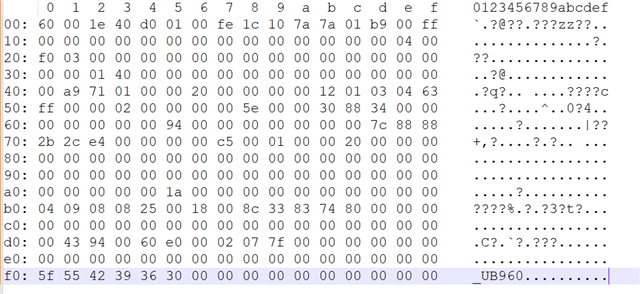

  1. we are getting the alias address of serializer and camera sensor are same in ds90ub960 deserializer register after driver init.
Register dump of Deserializer(UB960)
in our case both alias addresses are 0x76.

    i am using imx390 with serializer address 0x18 and sensor address 0x1a.
    in above screenshot we can see that serializer alias address and remote sensor address are same
    [    6.877204] ds90ub960 0-0030: rx0: remote serializer at alias 0x76 (0-0076)
    [    8.428055] ds90ub960 0-0030: rx0: client 0x1a assigned alias 0x76 at slot 0
    if the alias address of both serializer and sensor then how SOC will communicate with serializer and sensor.

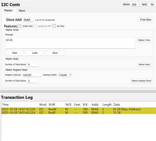

    i have captured the i2c line from i2c reader when the board is booting.
    i2c captured logs: -
    we can see that when the imx390 driver try to read the camera ID SOC send the 0x76 alias address. because of the same alias address, it's not able to get the correct ID from the camera module.
    i have attached the dmesg logs also: -

  • Hi Jay,
    Camera module is verified and working properly. We have tested the camera with other board.
    Sensor revision ID is 3815. when we are reading the revision ID from external i2c reader, we are getting the proper ID (3815).
    But SDK driver is not able to read the revision ID.
    Satyajeet

  • Hi Satyajeet,
    I noticed that there are a lot of parity errors and the register 0x5d in the deserializer is not initialized correctly. For reference, here is the register dump from my deserializer:
         0  1  2  3  4  5  6  7  8  9  a  b  c  d  e  f    0123456789abcdef
    00: 7a 00 1e 40 d0 01 00 fe 1c 10 7a 7a 01 b9 00 ff    z.?@??.???zz??..
    10: 00 00 00 00 00 00 00 00 00 00 00 00 00 00 04 00    ..............?.
    20: f0 03 00 00 00 00 00 00 00 00 00 00 00 00 00 00    ??..............
    30: 00 00 01 40 00 00 00 00 00 00 00 00 00 00 00 00    ..?@............
    40: 00 a9 71 01 00 00 20 00 00 00 00 12 01 03 04 64    .?q?.. ....????d
    50: 00 00 00 03 00 00 00 00 5e 00 00 30 88 34 00 00    ...?....^..0?4..
    60: 00 00 00 00 00 94 00 00 00 00 00 00 00 7c 88 88    .....?.......|??
    70: 2b 2c e4 00 00 00 00 c5 00 01 00 00 20 00 00 00    +,?....?.?.. ...
    80: 00 00 00 00 00 00 00 00 00 00 00 00 00 00 00 00    ................
    90: 00 00 00 00 00 00 00 00 00 00 00 00 00 00 00 00    ................
    a0: 00 00 00 00 00 1c 00 00 00 00 00 00 00 00 00 00    .....?..........
    b0: 04 09 08 08 25 00 18 00 fc 33 83 74 80 00 00 00    ????%.?.?3?t?...
    c0: 00 00 00 00 00 00 00 00 00 00 00 00 00 00 00 00    ................
    d0: 00 43 94 00 60 e0 00 02 07 7f 00 00 00 00 00 00    .C?.`?.???......
    e0: 00 00 00 00 00 00 00 00 00 00 00 00 00 00 00 00    ................
    f0: 5f 55 42 39 36 30 00 00 00 00 00 00 00 00 00 00    _UB960..........
    1. Can you send the hex dump again if it has changed? The 5d register corresponds to the address of the camera. The correct value for that should be 0x34 which when parsed would correspond to 0x1a.
    2. If possible, please share the part of hardware schematic for i2c connections.
    3. The gpio fields in the dtso are commented out. Please see if uncommenting those helps.
    Jay

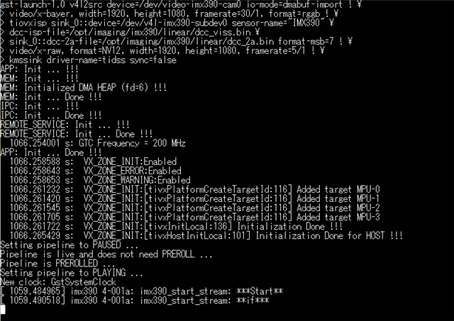

  • Hi Jay,
    We are able to detect the camera now.
    But when i am trying to stream the camera on HDMI display using below command: -
    gst-launch-1.0 v4l2src device=/dev/video-imx390-cam0 io-mode=dmabuf-import ! \
    video/x-bayer, width=1920, height=1080, framerate=30/1, format=rggb ! \
    tiovxisp sink_0::device=/dev/v4l-imx390-subdev0 sensor-name="IMX390" \
    dcc-isp-file=/opt/imaging/imx390/linear/dcc_viss.bin \
    sink_0::dcc-2a-file=/opt/imaging/imx390/linear/dcc_2a.bin format-msb=7 ! \
    video/x-raw, format=NV12, width=1920, height=1080, framerate=5/1 ! \
    kmssink driver-name=tidss sync=false
    i am not able to capture the frames.
    after start streaming it stuck, and no frame are showing on display.

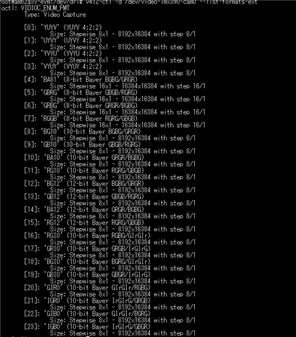

    output of  v4l2-ctl -d /dev/video-imx390-cam0 --list-formats-ext:-
    Satyajeet
  • Hi Satyajeet,
    The default setup for the camera sensor is rggb12 output at 1936x1100 resolution. While the camera supports multiple modes, the subdevices are setup with the routes corresponding to this. Due to this reason, the pipeline does not work. To change the default setup, you can have a look at the following file: /opt/edgeai-gst-apps/scripts/setup_cameras.sh line 37 (IMX390_CAM_FMT variable).
    Another thing that you can do to generate gstreamer pipelines is use the optiflow scripts. The file: /opt/edgeai-gst-apps/configs/imx390_cam_example.yaml is the default config file. For full documenation, you can have a look at this file: /opt/edgeai-gst-apps/configs/app_config_template.yaml. While these scripts are primarily for analytics workflows, setting the model as null will prevent running any analytics. Here is the updated config file:

    For running it, you can run the following command from /opt/edgeai-gst-apps directory(The default login directory for the AM62A):
    ./optiflow/optiflow.py configs/imx390_cam_example.yaml
    The resulting gstreamer pipeline that is run is as follows:
    v4l2src device=/dev/video-imx390-cam0 io-mode=5 ! queue leaky=2 ! video/x-bayer, width=1936, height=1100, format=rggb12 ! tiovxisp sensor-name=SENSOR_SONY_IMX390_UB953_D3 dcc-isp-file=/opt/imaging/imx390/linear/dcc_viss.bin format-msb=11 sink_0::dcc-2a-file=/opt/imaging/imx390/linear/dcc_2a.bin sink_0::device=/dev/v4l-imx390-subdev0 ! video/x-raw, format=NV12 !  tiovxldc dcc-file=/opt/imaging/imx390/linear/dcc_ldc.bin sensor-name=SENSOR_SONY_IMX390_UB953_D3 ! video/x-raw,format=NV12,width=1920,height=1080 ! \
    tiovxmultiscaler src_1::pool-size=4 name=split_01 target=0 \
    split_01. ! queue ! video/x-raw, width=1920, height=1080 ! \
    kmssink driver-name=tidss sync=false force-modesetting=true
    Also, can you please clarify what the issue with the IMX sensor not being detected was?
    Jay
  • Hi Satyajeet,
    Going through the datasheet, the sensor outputs 1936x1096 width frame which is cropped to 1920x1080 during ldc. So, the output from the LDC gstreamer node is actually 1920x1080 resolution. So, you should be able to remove the multiscaler node from the pipeline. The resulting pipeline would be:
    v4l2src device=/dev/video-imx390-cam0 io-mode=5 ! queue leaky=2 ! video/x-bayer, width=1936, height=1100, format=rggb12 ! \
    tiovxisp sensor-name=SENSOR_SONY_IMX390_UB953_D3 dcc-isp-file=/opt/imaging/imx390/linear/dcc_viss.bin format-msb=11 \
    sink_0::dcc-2a-file=/opt/imaging/imx390/linear/dcc_2a.bin sink_0::device=/dev/v4l-imx390-subdev0 ! video/x-raw, format=NV12 ! \
    I don't see a mention of RAW8 format in the datasheet, so I am not sure if this is supported.
    Jay
