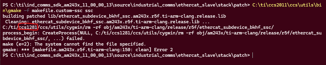

I'm trying to patch Beckhoff slave sample code to industrial communication SDK, but I'm keep getting the following error:
What's a proper way to update the correct path?

Hello Kwan,
The ind_comms_sdk_am243x_11_00_00_13 supports CCS version 12.8.1. Please install this CCS version and follow the same steps.
Kind Regards,
Hi Kwan,
You can modify imports.mak file in the SDK root folder to match with your CCS version.
Do note that we haven’t validated SDK 11.00 with CCS Theia. CCS 12.8.1 is the recommended version.
