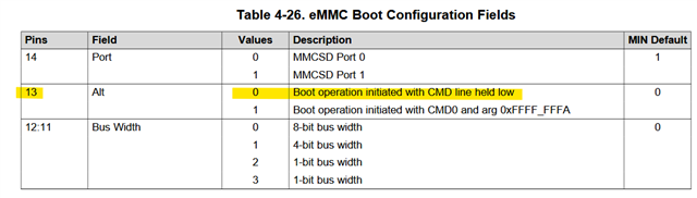

    Can you please re-test with a oscilloscope all BOOTMODE pins are at expected values around the time POR is being de-asserted after a power cycle?
    It might be an external device driving one or more BOOTMODE pins leading to wrong boot mode being selected or e.g. pin 13 is selecting CMD0 with 0xFFFF_FFFA:

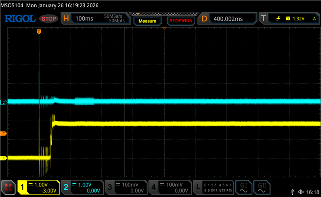

    Behavior of the evaluation board after power-up: Blue: MMC0_CLK, Yellow: MMC0_CMD
    Behavior of the custom board after power-up: Blue: MMC0_CLK, Yellow: MMC0_CMD

    I see the MMC0_CLK is NOT available on your custom board for some reason. Can you please check if the corresponding SoC pin output buffer is not forced to an OFF state in software (i.e. corresponding pad-configuration register bit[21] TX_DIS = 0b1) ? The TX_DIS bit should be set LOW to allow the MMC0 IP to output the clock signal at the SoC MMC0_CLK pin.
