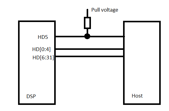

I'm in a doubt about HPI width configuration. As per SPRS226M, HD5 is specified as configuration pin:
0 − HPI operates as an HPI16. (HPI bus is 16 bits wide. HD[15:0] pins are used and the remaining HD[31:16] pins are reserved pins in the Hi-Z state.)
1 − HPI operates as an HPI32. (HPI bus is 32 bits wide. All HD[31:0] pins are used for host-port operations.)
Later it is said that there is no internal pulling resistor on HD5 pin:
internal pullup/pulldown resistors exist on these pins (except for HD5/AD5)
And later:
Host-Port bus width user-configurable at device reset via a 10-kΩ resistor pullup/pulldown resistor on the HD5 pin
So do I understand correctly, that among all HD lines HD5 is special. I mean that All HD lines connected directly between DSP and host processor, but HD5 has one extra connection in the middle between DSP and host (like on attached picture), and that connection through 10 kOhm resistor defines port width. Is this correct?
Thanks in advance.
  • If PCI_EN=0, then you must have a 10-kOhm resistor either pulling HD5 high or low depending on the configuration you want to use.
    Your understanding does seem to be correct, but I do not want to reword what is in the datasheet. The datasheet's explanation is the final word, and there does not appear to be a conflict between any of the statements you have pulled from it.
    Your picture is correct for HPI32 operation. It shows a single pull-up resistor on HD5.

  • Hello RandyP,
    Thank you for quick response.
    I was a bit curious about described operation mode. I mean that configuration resistor connected to the data line, not dedicated config pin. As you mentioned, there is no contradiction in data sheet citations, I did not meant it. Just I wanted to make sure I got the idea right. Perhaps, resistor leakage is smaller than normal operation currents, so it does not affect normal operation of the bus, but still enough for DSP to sense configuration level at reset time.
