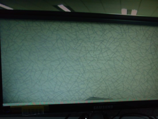

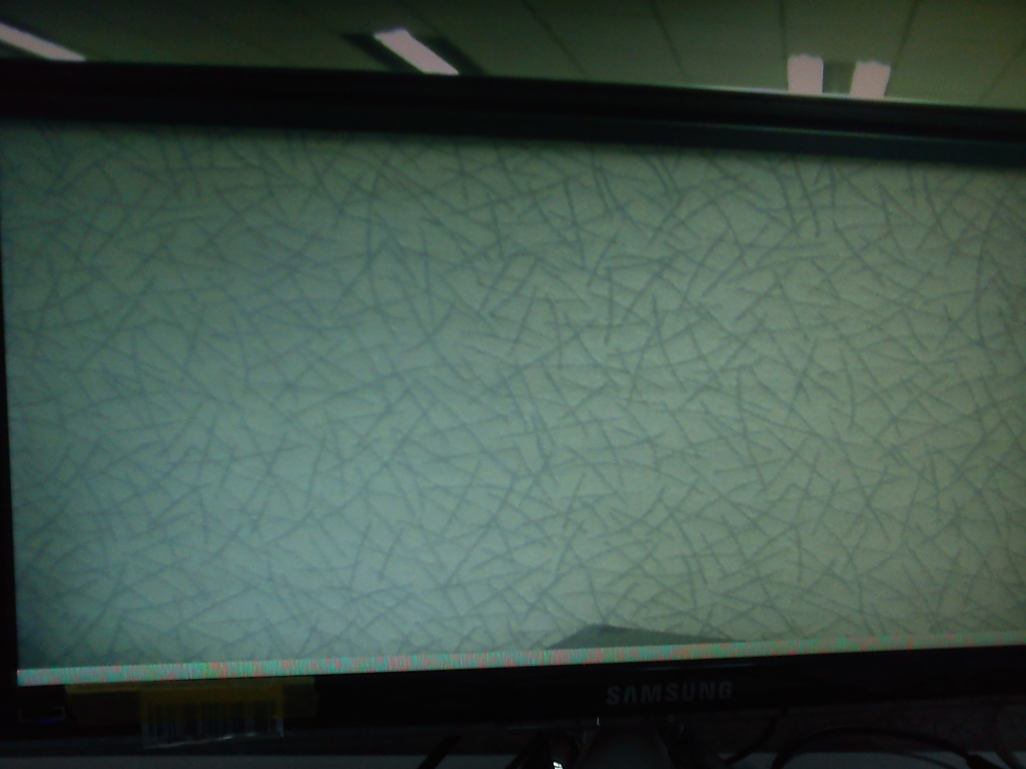

  • Hi, I tried to create a 1080P OMTB script , why I get is a gray square on the display. (DM8168 ,EZSDK505)
    I change SetpIndex.c as follow:
    SetpIndex.c
    /* Entry for Set Selecting Video Decoder Standards */
    PRIVATE MX_DBG_CMD_ENTRY_T cmdEntryVPSSTvpVideoDecoderStd =
      "videoStandard",
      MX_DBG_CMD_TYPE_VAR_UINT32,
      MX_DBG_CMD_OPT_INST_CUR     |
      MX_DBG_CMD_OPT_ENUM         |
      MX_DBG_CMD_OPT_VALID_PTR,
      FIELDOFFSET(OMX_PARAM_CTRL_VIDDECODER_INFO,videoStandard),
      FIELDOFFSET(OMX_PARAM_CTRL_VIDDECODER_INFO,nSize) -
      0,
      OMX_VIDEO_DECODER_STD_Unused,
      OMX_VIDEO_DECODER_STD_1080P_60,
      OMX_VIDEO_DECODER_STD_MUX_4CH_D1,
      &enumTblVPSSTvpVideoDecoderStd,
      XdbgCmdVarFunc,
      "TVP video decoder standards...................",
    #omx omtb_dbg_lvl 0x00
    #omx omtb_dbg_lvl 0x04
    #omx omtb_dbg_lvl 0x08
    #omx omtb_dbg_lvl 0x10
    #omx omtb_dbg_lvl 0x80

    As requested earlier, please refer to examples provided e.g. capture_encode, decode_display etc. OMTB does not support all component supported features.
    Vimal
  • Thanks for your answer.
    But I don't understand why there is a gray square on dispaly. I refered to capture_encode, decode_display.
    Can you help me how to get rid of the gray square?
    Thanks.
  • I assume, this is due to capture not getting detected. So it is in loop for detecting the capture.
    Vimal
  • Sorry, I am not very clear what you mean. If there has no NF, the display is normal.
  • I tested the capture component, the display is normal(capture-dei-display). Can you help me?
    Thanks very much.
  • Are you using latest SDK ? 5.05.01.04 ?
    There is an example decode_display , where NF is used; you can refer that. Please note NF has limitation of height /width beinG multiple of 32.
    Vimal
  • Yes, it's EZSDK5.05.01.04.
    In the example decode_display, the note is:
    /* SD display is through NF in this example, and NF has limitation of multiple of 32 ;
    so I tested using 720P60, but the display is same as 1080P60. It also has a gray rectangle in the bottom of screen.
    Can you help me?
  • Hi, can you help me?

  • Hi, Vimal, can you help me?
    there is a gray rectangle in the bottom of screen.
    why the display is no normal ?
    The configuration  of NF is as following:

    What is width /height you are using. Please note NF has limitation of these to be multiple of 32. Without algEnable ( ie just the color conversion,) do you see same result ?
    Vimal
  • Hi, Vimal
    Thanks very much for your reply.
    I tested using 720P, the result is same. Can you check for this?
    Thanks.
    720 is not multiple of 32, So NF would not work as expected.
    Vimal
  • Hi, Vimal
    I refer the Nf component of example decode-display. I handle the issue of multiple of 32.
    The result of 720P is relatively normal, but there are flashes.
    However,  the result of 1080P is not very normal, I can't completely removed the excess part, just has a little in screen and also many flashes.
    How can I make the display becomes normal?
    Can you help me?
    Best regards.
    Could you please let us know about your use case. Also Do you see extra video padding or video is totally garbage. It will help if you could post a clip?
    Vimal
