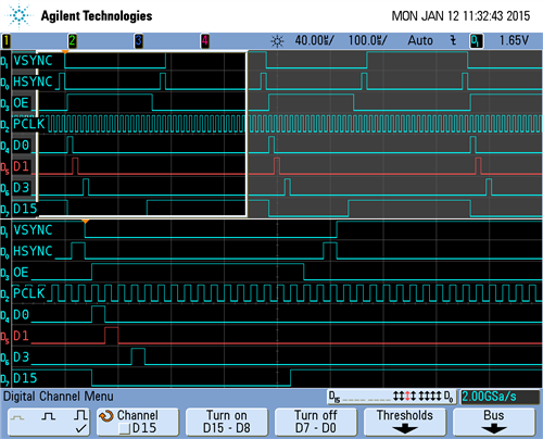

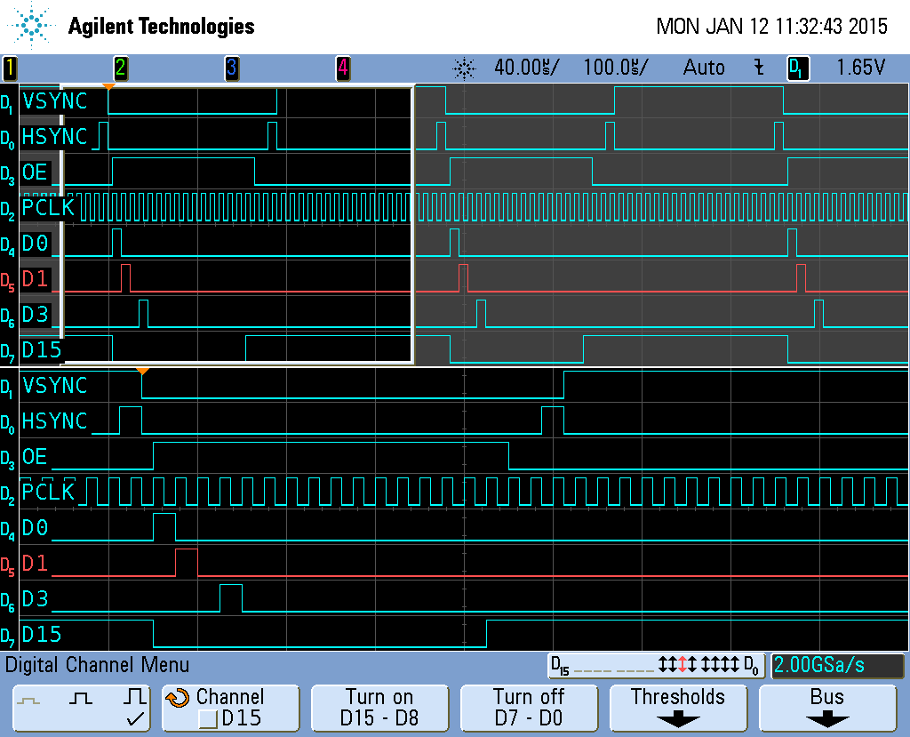

  • I would also like to share my codes to make the LCD running. It is not perfect yet, but at least my bare metal codes were basically working. I found a lot of helpful info from AM335x StarterWare and TI WiKi, i.e. GEL scripts and doc about programming LCD registers, as well as setting up DDR2 memory properly.
    Environment: one custom PCB with AM335x and DDR2 SDRAM,  one 3.5" LCD with 320x240 and 16BPP mode, and Code Composer Studio v6. In my case, AM335x MPU is running at 300MHz, DDR2 clock running at 150MHz, and LCD pixel at 5MHz.. They can be set to any frequency to tailor your application though. Right now I was able to display a test pattern with color strips on the screen.

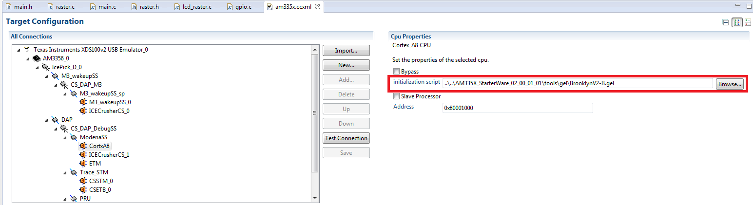

    1. I modified AM335x_EVM.gel a little bit so as to initialize the processor in CCS.  This includes setting up OPP100 mode by configuring 5 PLLs including display PLL, and also set up EMIF for DDR2 SDRAM. Not sure if each of PLLs has to be configured, but I did all since they will be useful for  future development  anyway.
    I set up Display PLL with 50MHz output as LCD_CLK. It serves as input clock to LCD peripherals, which I further divided down to 5MHz as pixel clock. Note on AM335x StarterKit it was using output of Perihperal PLL at 192MHz as LCD clock input, but this should work the same way.
    Configuring EMIF is necessary as it's the storage address for LCD frame butter (usually starting at 0x80000000). I believe following the steps in the TI Wiki page below will make your DDR2 up running. Eventually in Memory Browser of CCS, you should be able to navigate to address at 0x80000000 and write to any address after it.
    http://processors.wiki.ti.com/index.php/AM335x_EMIF_Configuration_tips
    Note: ARM mode in CPSR register should be set to "privilege (0b10111)" instead of "user (0b10000)", or else writing to EMIF registers won't work. I haven't figure out an easier way to do it. Thus each time I launched the debug mode, I had to set it manually in Register View window.
    2. Create CCS Project with AM335x. Then I attached the GEL as init script of AM335x.ccxml so that both the processor and DDR2 interface could be automatically initialized each time CCS is connecting to a target board in debug mode. It is in AM335x.ccxml->"Target Configuration" and looks like this:
    3. Run codes to init the LCD peripheral. Page#112 of AM335x StarterKit User Guide explains details of  programming sequence for raster LCD. More codes could be found from AM335x StarterWare. I put my codes below for whoever might need it, but please bear with my non-standard coding style as being mostly a hardware engineer.
    Note: the codes I used won't make the LCD display perfectly, as I have seen some horizontal offset on the screen, but at least I was able to see something. I will update separately if I figured it out the root cause.

    Once raster controller is enabled, you should be able to see all 3 clocks (Pixel, HSYNC, VSYNC) from the scope.
