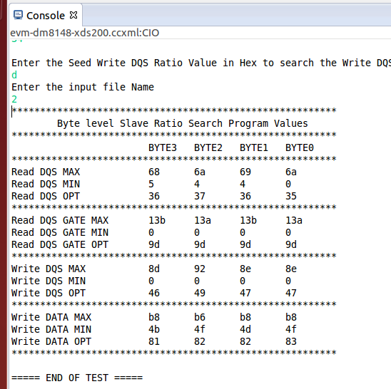

When we browse through the TI forums, found a procedure to do a software levelling http://processors.wiki.ti.com/index.php/TI814x-DDR3-Init-U-Boot  which is a necessary thing to configure the DDR3 memory. When I run the DDR3_SlaveRatio_ByteWiseSearch_TI814x.out from CCS, I am getting the ratio values as 0s. So I am not able to proceed further from this point. I have captured the log of Slave_Ratio tool. Please check it below.

  • Vinod,
    Are you able to access the DDR before running the leveling algorithm? Have you configured your DDR parameters properly before running the algorithm? The algorithm will work only if the DDR configurations are correct and the algorithm's scope is limited to findout the right leveling parameters only.
  • Hi Ranjith,
    Thanks for the reply. I solved this issue long back. Yes, I was able to access the DDR. But my page size parameters were wrong. After I corrected those values, it was working fine. The leveling algorithm was really helpful for me to solve these issues.

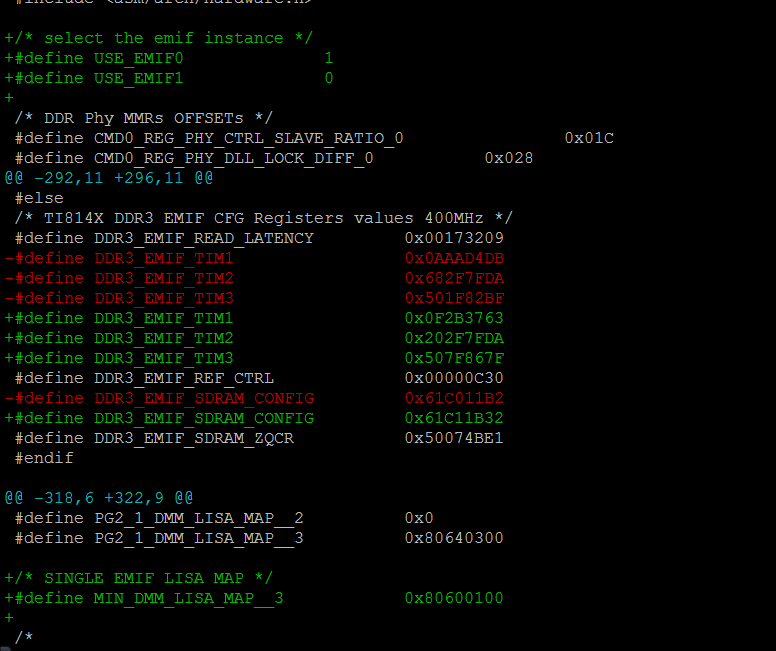

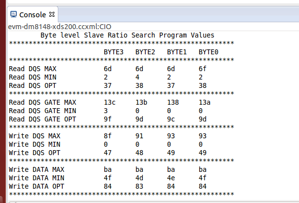

  • Using the MT41K128M16 , after change the timing of ddr in the gel file,DDR3_SlaveRatio_ByteWiseSearch_TI814x.out works fine.
    //DDR3 400 MHz - CL=6,CWL=5
    #define    DDR3_EMIF_TIM1_DEFINE_400            0x0AAAD4DB
    #define    DDR3_EMIF_TIM2_DEFINE_400            0x682F7FDA
    #define    DDR3_EMIF_TIM3_DEFINE_400            0x501F82BF
    #define    DDR3_EMIF_REF_CTRL_DEFINE2_400        0x00000C30
    #define    DDR3_EMIF_SDRAM_CONFIG_DEFINE_400    0x61C012B2
    #define    DDR3_EMIF_READ_LATENCY_DEFINE_400    0x00173209
    #define    DDR3_EMIF_TIM1_DEFINE_400            0x106B3763
    #define    DDR3_EMIF_TIM2_DEFINE_400            0x202F7FDA
    #define    DDR3_EMIF_TIM3_DEFINE_400            0x507F867F
    #define    DDR3_EMIF_SDRAM_CONFIG_DEFINE_400    0x61C11B32
    ddr0:
    ddr1:
    so in the u-boot,make a change:
