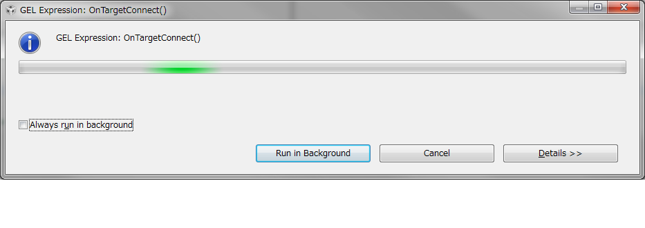

  • Hi Rahul-San,
     Thank you for your feedback. I tried to update the code to AM1808 EVM through XDS100v2, but I was not able to do it. JTAG connection was not completed from CCS. Please refer to the attached picture.
    This progress was not finished. If the boot pin configuration is changed to JTAG emulation mode, JTAG connection is succeeded and the code can be updated.
     Any idea why JTAG connection was not completed in my case. GEL file might be modified?
    Masa
  • Okay, I understand your usecase better now. When you write an boot image to the SPI flash and maintain the same switch settings to boot, the AIS boot image in the flash initializes your device(PSC,PLL,PINMUX, DDR) the same way as the GEL file does and loads the application binary in the memory.
    So when you try to reconnect the device using a JTAG, you should remove the GEL file because the onTarget function in the GEL tries to reinitialize the power domains (LPSC), PLLs and PINMUX and DDR settings when it has already been initialized and in use.
    Please let us know if you are still not able to connect to the device after removing the GEL file.
    Rahul
  • Hi Rahul-san,
     Thank you very much for your support. The code in SPI flash can be updated without changing the boot pin configuration. As you advised, it can be performed by removing GEL file.
