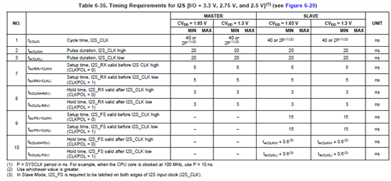

Thank you for your response, but it seems you do not quite understand the point of my question.
I know the performance characteristics of the internal SAR ADC however internal ADC of the C5515 does not meet my performance needs. Thats why i need to expand the c5515 ezdsp USB stick with high speed (up to 50 MHz) ADC daughter card (using expand connector, I2S bus and DMA transfer to internal memory). So the both questions mentioned above are steel interesting for me.
viz. Questions: 1) Is it possible to take data from ADC to main memory at this speed?
