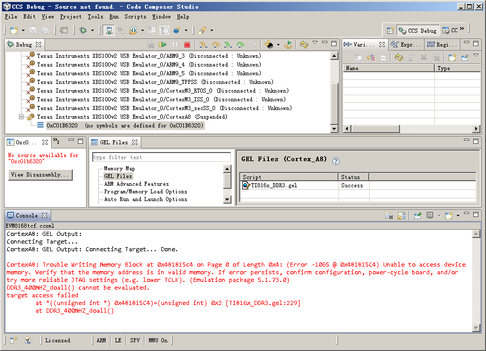

  • Hi Badri,
        I have succeffully installed the CCSv5.4 and connected our custom board with the JTAG emulator, XDS100v2, which is in our EVM Kit Box.
       When I tried to load the "TI816x_ddr3.gel" and executed the "DDR3_400MHz_doall", terminal in CCSv5.4 cast some error info as below:
    CortexA8: GEL Output:
    Connecting Target...
    CortexA8: GEL Output: Connecting Target... Done.
    CortexA8: Trouble Writing Memory Block at 0x481815c4 on Page 0 of Length 0x4: (Error -1065 @ 0x481815C4) Unable to access device memory. Verify that the memory address is in valid memory. If error persists, confirm configuration, power-cycle board, and/or try more reliable JTAG settings (e.g. lower TCLK). (Emulation package 5.1.73.0)
    DDR3_400MHZ_doall() cannot be evaluated.
    target access failed
        at *((unsigned int *) 0x481815C4)=(unsigned int) 0x2 [TI816x_DDR3.gel:229]
        at DDR3_400MHZ_doall()
       How can I solve this problem?  Could you give me some tips?
       I am sincerely looking forward to your reply.

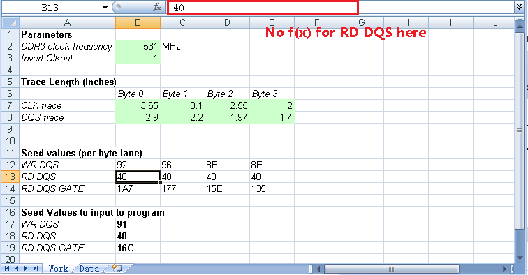

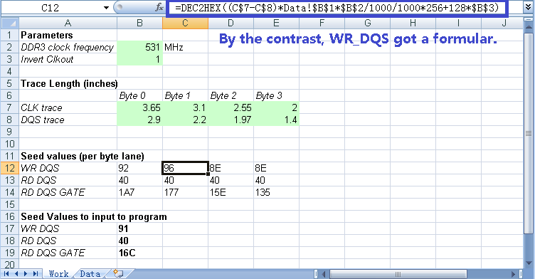

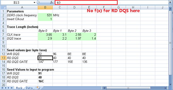

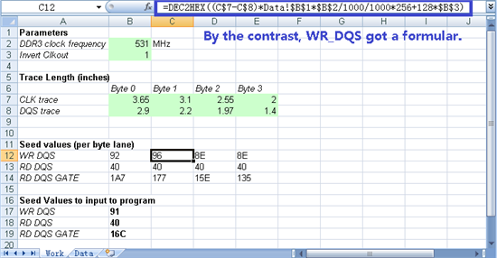

  • This still indicates DDR is not stable. Did you populates the DQS values based on running the s/w level search algorithm on your board ? Try reducing the DDR frequency to check if stability improves.
  • Hi Badri,
       I am going to reduce the DDR3 freq and rebuild the u-boot.  One more question by the way, I find there are not any functions(formula for calculating data) for "RD DQS" in the "Ratio_seed.xls" sheet.  Shall I set these parameter manally?  How can I get these parameters?
       I manage to set the RD_DQS to the default "0x40".  Is it OK?

  • Hi Badri,
          I have followed your suggestion and reduced the DDR3 freq to 400MHz.  The VDEC + VDIS demo runs stably without any error for 2 hours.
          After changing the DDR3 clock frequency to 531MHz.  The same demo cast some Internal Error.  Yet the system is not collapsing until the "Unhandled Exception" occurs a few minutes later.
