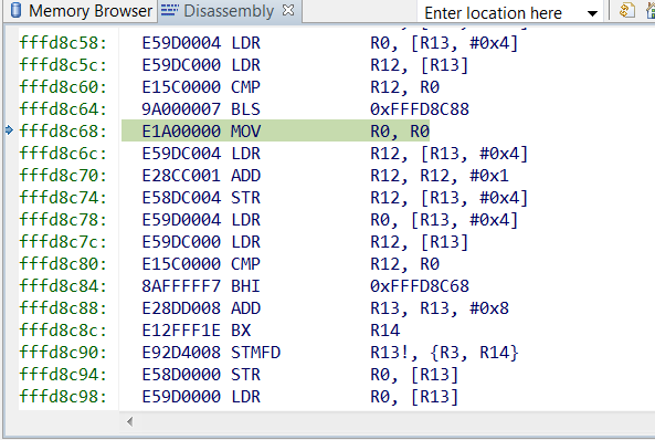

    After the (failed?) boot can you connect with CCS, load symbols for the corresponding executable, and see where the PC is pointing?  I'm wondering if you're still in a "good state" after the boot or if you're off in an error vector somewhere.
  • Sorry, I've never loaded symbols so you'll have to help with that. Looking at the debug output after booting this card shows this:
    Program Counter (PC) = 0xFFFD8C7C
    and PLL0_SYSCLK1 = 24MHz
    The SD clock is really odd, very slow and it looks like it changes frequency, it's much less than 1MHz but since we're not at 300MHz that might make sense.

    If nothing else, please look in a disassembly window to see where it's at.  If you do View->Registers you should be able to find the PLLs and MMC registers.  I'd love to see those values to try to make some kind of connection of what's going on here...  So weird!

  • I loaded symbold (by pointing to the uboot elf file). Not sure if that is what I was supposed to do and I'm not sure what you wanted to see. I've attached a full dump of the registers for reference but here's the PLL registers:

    and here's what you get when you open a disassembly window:
  • Ok, just had a webex with George.  Here are a few important points we discovered:
    1. For the code from LogicPD it's important to note that you should not define NO_GEL.  In other words comment out the line with #define NO_GEL...  Otherwise it attempts to reconfigure DDR settings.
    2. For the SD/MMC speed we used 25 MHz.  This should be safe as all SD cards should support it.  Only some support 50 MHz.
    3. For the PSC, we enabled all the domains except SATA.  (Do not put anything in the "Disable LPSC" domain line.  Unneeded peripherals are disabled by default already.)
    EDIT: The ones above are in addition to the critical discovery earlier in the thread that we needed to make some further edits to uflash.  George, would you mind posting your final working version of uflash?  I'll go ahead and put it on the wiki.  I've tried to clean up a few other items on there as well.
