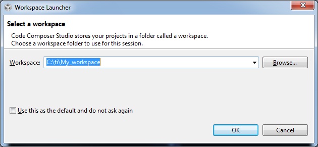

Dear All,
I am using 6678EVM with CCS V5.5. I installed the MCSDK from cd, which comes along with the kit.
I  imported the project image_processing_openmp_evmc6678l  from the below location
C:\ti\mcsdk_2_01_02_05\demos\image_processing\openmp\evmc6678l
When I try rebuilding the project I am getting the following errors
unresolved symbol EVM_init, first referenced in G:\6678Workspace\hua_evmc6678l\Release\configPkg\package\cfg\evm_pe66.oe66
unresolved symbol hpdspuaStart, first referenced in G:\6678Workspace\hua_evmc6678l\Release\configPkg\package\cfg\evm_pe66.oe66

  • Hi Dinesh,
    1. Launch CCS by double-clicking the icon on the desktop. - As CCS initializes, a pop-up will appear with a default workspace. Replace the default workspace with “C:/ti/My_workspace”. (refer attached screen shot)
    2. Import the example project as follows:
             2a. Select the CCS menu option Project Import Existing CCS Eclipse Project
             2b. Set Select search directory to locate the example projects available for your EVM:
                    • (C6678L/LE) - C:\ti\mcsdk_2_01_02_06\demos\image_processing\openmp\evmc6678l
             2c. Place a uncheck mark on Copy projects into workspace.
             2d. Click the Finish button.
    3. Right-click on the project in Project Explorer and select Build Project.
    Please follow the above step and let me know the status.
