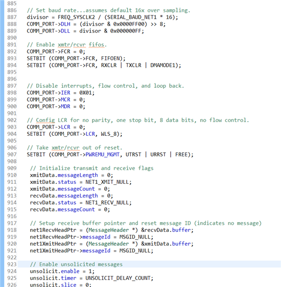

    D3. I've attached the code for polling and setting the LED pin. I also included the DMA set up, figuring you may very well need it down the road.

    This code is how we initialize the DMA
    void net1_edmaInitialize (void)
        int i;
        // DATA PARAMETERS PROVIDED BY APPLICATION
        // Configure EDMA for UART Inputs
        unsigned int chType     = EDMA3_CHANNEL_TYPE_DMA;
        unsigned int chNum      = DMA_INPUT_CHANNEL;
        unsigned int reloadParamChNum = DMA_INPUT_RELOAD_CHANNEL;  // Set this up now, it is to be used by the Reading Function
        unsigned int tccNum     = DMA_TRANSFER_CONTROLLER;
        unsigned int evtQ       = EVENTQ;    // Event Queue used
        EDMA3Init(DMA_CONTROLLER_ADDRESS, evtQ);
    	volatile char *srcBuff;
    	volatile char *dstBuff;
        volatile unsigned int count = 0;
        unsigned int retVal = 0u;       // retVal is only needed to allow IT code to remain unchanged
        unsigned int acnt = MAX_ACOUNT;
        unsigned int bcnt = MAX_BCOUNT;
        unsigned int ccnt = MAX_CCOUNT;
        srcBuff = (char *) COMM_BASE;
        dstBuff = (char *) recvData.buffer;
        for (i = 0; i < 127; i++)
        	recvData.buffer[i] = 0XFF;
        retVal = edma_requestChannel(DMA_CONTROLLER_ADDRESS, chType, chNum, tccNum, evtQ);
        retVal = edma_requestChannel(DMA_CONTROLLER_ADDRESS, chType, reloadParamChNum, tccNum, evtQ);
        // Fill the PaRAM Set with transfer specific information
        paramSet.srcAddr  = (unsigned int) (srcBuff);
        paramSet.destAddr = (unsigned int) (dstBuff);
        paramSet.aCnt = (unsigned short) acnt;
        paramSet.bCnt = (unsigned short) bcnt;
        paramSet.cCnt = (unsigned short) ccnt;
        paramSet.linkAddr = 0xFFFF;
        // Setting up the SRC/DES Index
        paramSet.srcBIdx = 0;    //Static Uart Source
        paramSet.destBIdx = (short) acnt;
        // A Sync Transfer Mode
        paramSet.srcCIdx = (short) acnt;
        paramSet.destCIdx = (short) acnt;
        //  Enable Final transfer completion interrupt flag, and dynamic destination addressing
        paramSet.opt = 0;
        paramSet.opt |= (chNum << EDMA3CC_OPT_TCC_SHIFT);
        paramSet.opt |= (1 << EDMA3CC_OPT_TCINTEN_SHIFT);
        paramSet.opt |= (1 << EDMA3CC_OPT_ITCINTEN_SHIFT);
        paramSet.opt &= 0xFFFFFFFB;
        // Now, write the PaRAM Sets.
        edma_clrIntr (DMA_CONTROLLER_ADDRESS, chNum);
        edma_setParam (DMA_CONTROLLER_ADDRESS, chNum, &paramSet);
        edma_setParam (DMA_CONTROLLER_ADDRESS, reloadParamChNum, &paramSet);
        edma_enableDmaEvt (DMA_CONTROLLER_ADDRESS, chNum);
        chNum      = DMA_OUTPUT_CHANNEL;  //initialize the output channel as well.
        //assemble PaRAM information
        srcBuff = (char *) xmitData.buffer;
        dstBuff = (char *) COMM_BASE;
        // Fill the Param Set with transfer specific information except Bcnt
        paramSet.linkAddr = 0xFFFF; //Turn off after message is complete
        paramSet.srcBIdx = (short) acnt;  //Static Uart Source
        paramSet.destBIdx = 0;
        paramSet.opt = 0;
        paramSet.opt |= (EDMA3CC_OPT_DAM);
        paramSet.opt &= 0xFFFFFFFBu;    //A type transfer

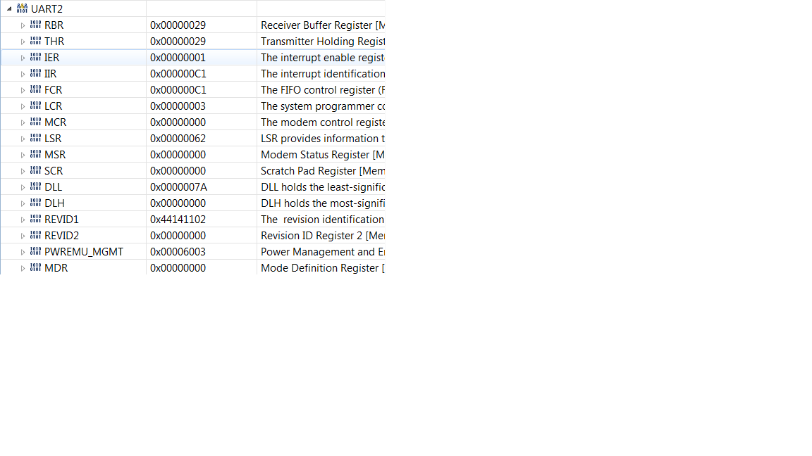

    My best guess right now is that the problem has to do with the interaction between the UART FIFO and its signalling an event to the EDMA3 module and then sending another event to the EDMA3 module. But my current understanding of your flow does not give me any quick guesses about how this all could work or does work.
    Would it be possible to setup a test where you service the UART using a DSP interrupt routine, and let it read one byte each time the interrupt comes in, like the EDMA3 would do? In that ISR you could pulse your GPIO pin, or another one, to see how long it is after the RXD line before you get into the ISR and out of it.
    Another related test, both with the DSP ISR and with the DMA would be to send the message one byte at a time, with a long time between them, like 300us or more. That would help to narrow the search for the delay point.

    If i'm not mistaken (please check my initialization) I have the DMA UART Rx Channel to trigger off of the UART data ready flag. But yes, this is really the source of confusion.

  • Randy,
    I ran a few more tests, while looking at the UART config a bit closer. I noticed that the delay from the end of incoming bytes as well as in between was 4 character lengths, suggesting that the timeout interrupt is triggering and not the FIFO data ready interrupt. This absolutely perplexes me as I think that we set that portion up correctly. I've attached our UART registers as well as the code for setting them up. Do you see anything that I don't?
    Thank you for your time and expertise on this matter,
    Sam Swerdlow
  • Sam,
    I think there are a couple of things going on here. The FCR configuration needs to be done differently and the DMA transfer needs to read more than 1 byte at a time. Here is what I am thinking:
    FCR configuration:
    Write-only registers are a big inconvenience. I have no idea why a chip designer would try to conserve register addresses in a 32-bit architecture, but someone decided to overlap the read-only IIR register with the write-only FCR. This means that when you do a read-modify-write operation like SETBIT(COMM_PORT->FCR, FIFOEN), it does not read the 0 previously written to FCR but instead reads whatever is in IIR, modifies that and writes out IIR+FIFOEN; not what you want to happen.
    There is a Caution in the TRM for the FCR saying
    TRM 30.3.5 CAUTION said:
    For proper communication between the UART and the EDMA controller, the
    DMAMODE1 bit must be set to 1. Always write a 1 to the DMAMODE1 bit, and
    after a hardware reset, change the DMAMODE1 bit from 0 to 1.
    My recommendation is to use the following 2 writes to make sure this Caution is met:
    COMM_PORT->FCR = 0;
    COMM_PORT->FCR = FIFOEN | DMAMODE1 | CHAR? | RXCLR | TXCLR;
    COMM_PORT->FCR = FIFOEN | DMAMODE1 | CHAR?;
    The extra writes are for an overabundance of caution and the last one may not be needed. The first one may not be needed either, but it might be an implied requirement from the Caution.
    The CHAR "?" is because I am not sure yet what you will want to choose for your FIFO Threshold. That is discussed later in this post.
