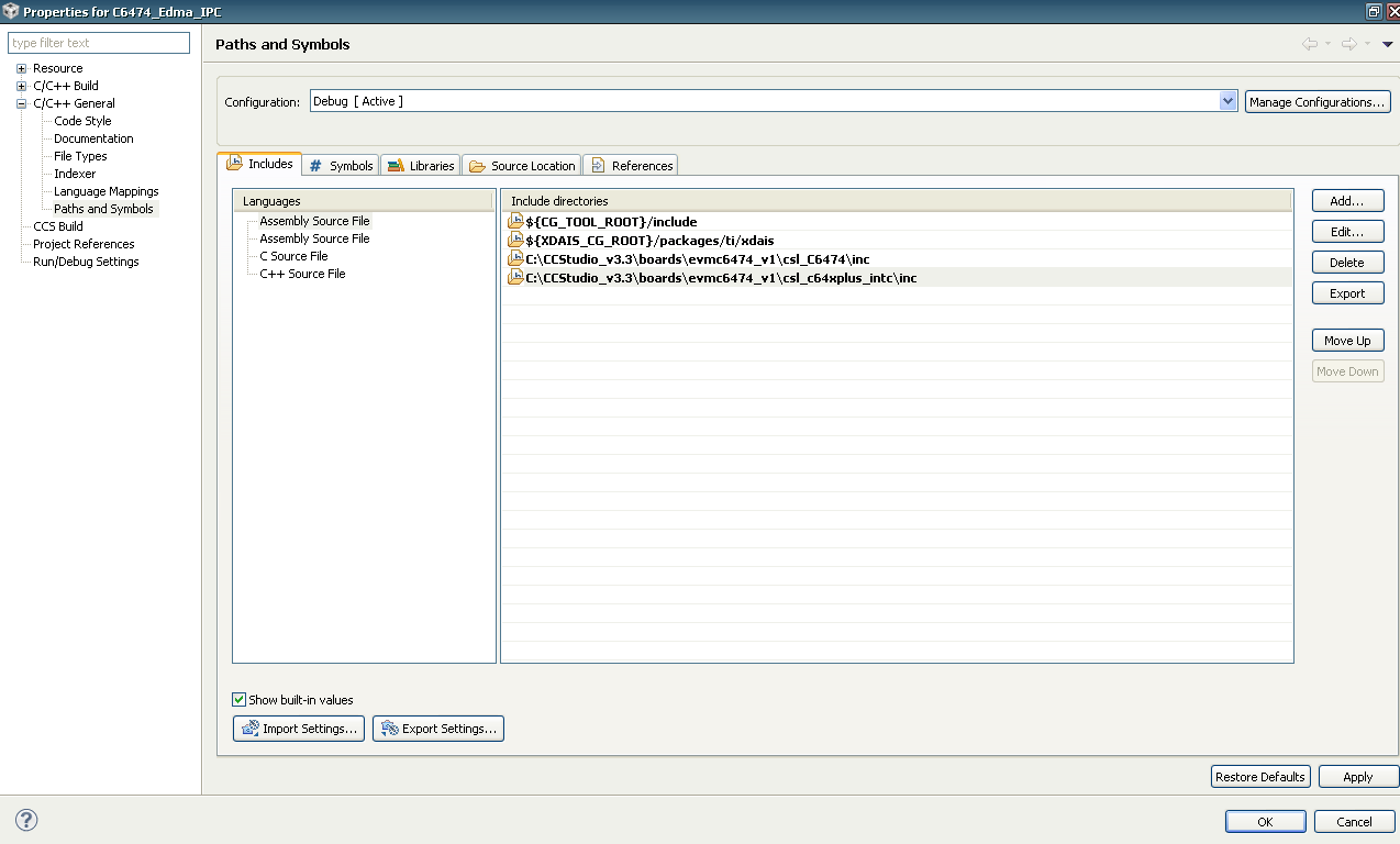

  • Hello Randyp
    Thank you for your help ,
    I followed the steps to import project like you mentionned above..
    but after building project the Errors appears in console (view attached image screen )
    other remark is i don't have the folder  csl_c64xplus_intc_c6474  ?
    I have just the two folder  below
    C:\CCStudio_v3.3\boards\evmc6474_v1\csl_c64xplus_intc
    C:\CCStudio_v3.3\boards\evmc6474_v1\csl_C6474
    so the you have any idea to resolve this problem ?

    I think that the easiest solution to your two errors are:
    1. Delete rts64plus.lib from the project list in CCSv4/v5. It will get picked up from the current compiler automatically and does not need to be there.
    2. Take your current C:\CCStudio_v3.3\boards\evmc6474_v1\csl_c64xplus_intc folder and copy it to C:/CCStudio_v3.3/csl_c64xplus_intc_c6474 so that it matches my installation.
    My personal choice for a case like this is to delete all three of the *.lib files from the project list. I am not used to seeing libraries in there, and I prefer to include them in the Build Properties. Using environment variables would make it much more portable, or copying the CSL folders into the CCSv4/v5 workspace so they are workspace- and project-relative would work, too. Then you have to make the same changes in C/C++ Build->Settings: under the Tools Settings tab and the C6000 Linker, click on File Search Path and manually add "csl.lib" and "csl_c64plus_intc.lib" in the Include library file box and manually add the two paths to your CSL folders in the Add <dir> to library search path box. You may want to delete the ${C6000_CSL_CG_ROOT}/lib line if it is in there.
    If either of these get your project to build successfully, that will be great. Please let me know what method you used and what your opinion is about the process. I almost always do the manual steps, partly so I know exactly where things are coming from when I do my build. But your opinion may be very different, and I would appreciate to read your opinion about this process.

  • Hello RandyP,
    for  final modifications who i made are :
    in paths and Symbols  :
    C:\CCStudio_v3.3\boards\evmc6474_v1\csl_c64xplus_intc\inc
    C:\CCStudio_v3.3\boards\evmc6474_v1\csl_C6474\inc
    ${XDAIS_CG_ROOT}/packages/ti/xdais
    ${CG_TOOL_ROOT}/include
    in the    C6474_Edma_IPC.pjt
    i deleted the line Source="..\..\C6000\cgt_6.1.11\lib\rts64plus.lib"
    After that   i build the project successfully  without any Errors or Warnings .
