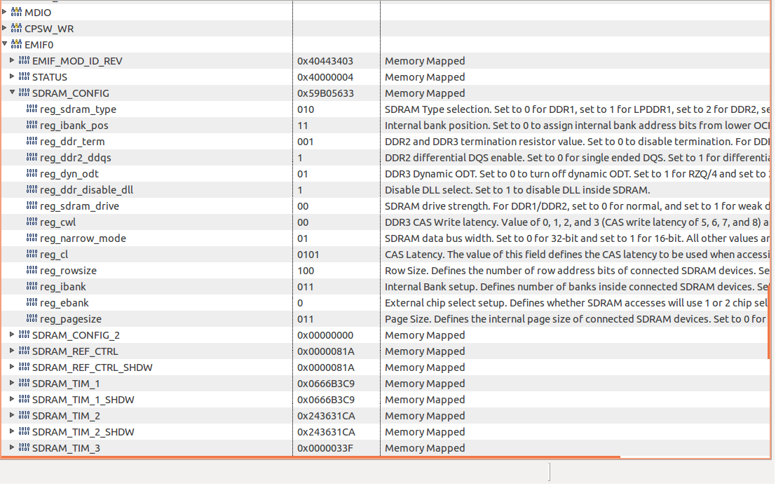

We have one MT47H64M16HR-25EITH part.  The only changes in the configuration settings were
1)  reg_rowsize field in SDRAM_CONFIG register was changed to 4 to represent 13 rows because the part has
64M x 16 has 13 rows, 10 columns and 8 banks x 16
2) reg_ibank_pos field was changed to 3 to allow 13 rows, 8 columns and 8 banks as shown in section 7.3.3.4.4 of reference manual SPRUH73J.

  • Did you change the pagesize to 3 (10 column bits)?
    UPDATE: As nchukeg points out later that should be 2.  Sorry!
  • Oleg, according to the datasheet for that part, the CL=5 which means the READ_LATENCY is 6.  I think if you change these 2 parameters in the EMIF configuration, that should resolve your read issues.
    James
  • The pages size was set to 3,  CL set to 5 and Read latency set to 6. Still no luck. Is there any clues to the fact that the memory only ever reads zero? I would suspect even if the timing was off that we would see garbage in the memory?

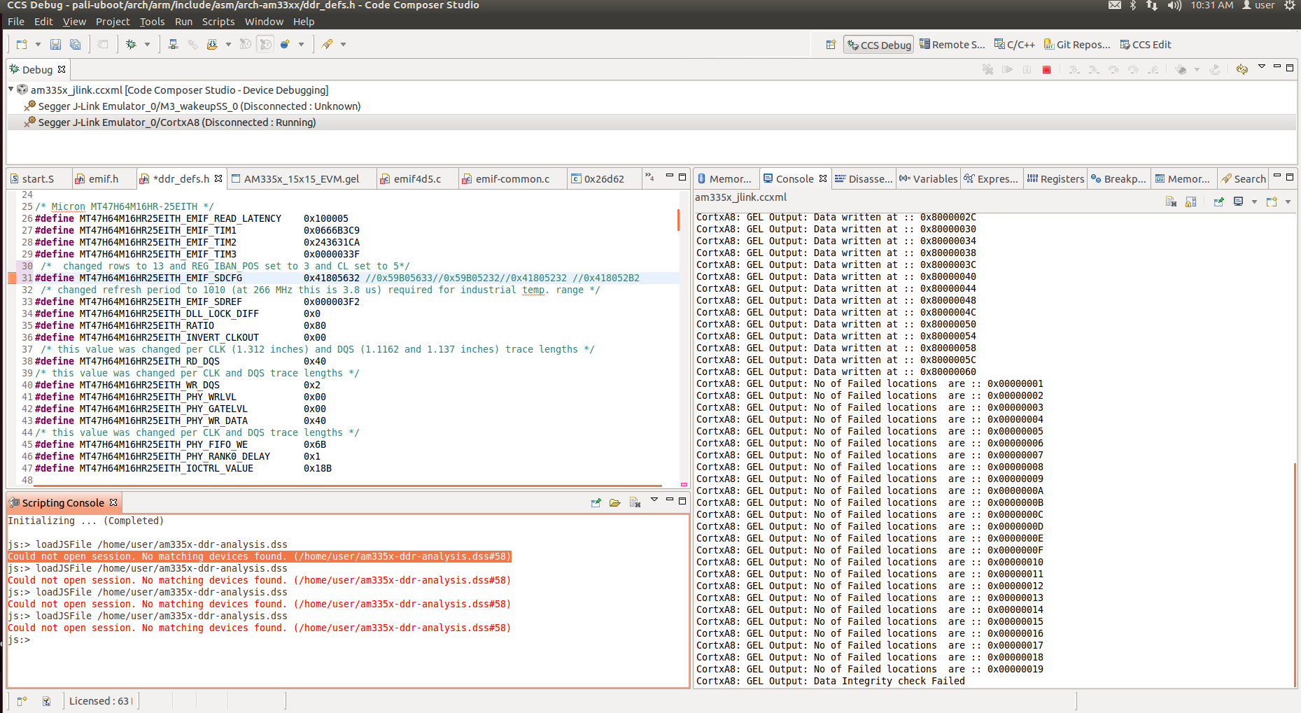

  • What software is being used to configure the EMIF?  Is this your own software, or is it something like u-boot or even a gel file?
    Can you please try running this diagnostic script I wrote:
    http://git.ti.com/am335x-dss-scripts/am335x-dss-scripts/blobs/master/am335x-ddr-analysis.dss
    The usage instructions are basically the same as this other script:
    http://processors.wiki.ti.com/index.php/AM335x_Clock_Tree_Tool#Importing_Data_from_Actual_Hardware
    Please attach the generated file to the thread.  Admittedly I wrote the file with DDR3 as the primary target, though it should still give us some insights into DDR2.  This might be a good opportunity for me to improve the script depending on what we find...
  • Tried with both a gel file (jlink) and uboot spl.  I will try the script out.
  • Hi Russ, let's back up a bit and confirm a few things:
    -what frequency are you running the DDR?  I assume 266MHz?
    -I think the SDRAM_CONFIG register should be  0x4180_5632.  The only things that changed from the EVM are row size (13 bits) and CL=5.
    -READ_LATENCY=6 as we have said already

  • I tried to run the script, but I get an error (see picture).

  • Ok I got the script to run here are the results
    EMIF: SDRAM_CONFIG = 0x41805632

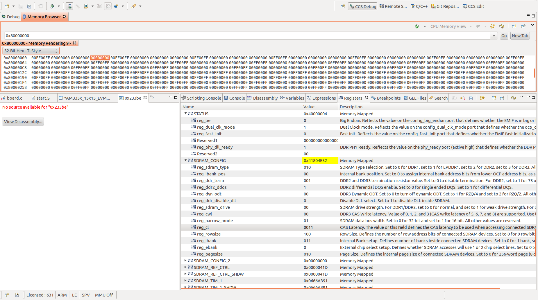

  • nchukeg said:
    DQS signals are not toggling and the data is not output following ACTIVATE and READ commands by the DDR controller on AM3352.
    The fact that you don't see DQS toggling AT ALL seems like something is drastically wrong, i.e. not just a minor timing issue or something along those lines.  I would suggest:
    1. Double-check your pin-out of the DDR2 device, i.e. make sure there's no error in transcribing from data manual to symbol.
    2. Measure impedance from DDR2's power to ground.
    3. Triple check that the proper voltages are seen on the DDR2.

    4) When I break after configuring the DDR2 and attempt to write to memory address.  On the scope I see a write command followed by a read command.
    The read command where DDR2 is in control of DQS and Data they are both low which tells me that DDR2 is simply not responding.  Since all of the lines are low, all zeros are interpreted by memory viewer
    What was needed to get the script to run?  I don't see anything obviously wrong there.

  • Maybe it was documented somewhere, but I missed it.  I just needed to modify the openSession to point to my debug configuration.
    debugSessionDAP = ds.openSession("*", "CortxA8");//"CS_DAP_DebugSS");

  • Im trashing now....  but if it I  set CL to 2 I the memory window changes from all zeroes to 00ff00ff  0000000 .....
  • Just to close out this thread, after some work directly with the customer, we found that the RAS and CAS signals had been swapped in the schematic.  After fixing this, DDR2 worked fine.
