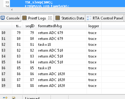

    Although sarISR is interrupted continuously (through breakpoint setting inside ISR), task is not run at all. Considering SAR can only be 64k SPS maximum, it is weird.
    I also see IER0/SAR: 0-DISABLE while IFR0/SAR: 1-ENABLED. This project uses DSP/BIOS 5.42.1.09. The HWI_INT13 for SAR INTC is correct?
    I write my code on earlier post is from the following csl_sar_IntcExample.c. I think that sarISR(void) generates 40 ADC data. Thus, I can make HWI void sarISR(void) run forever. In my BIOS project, void sarISR(void) will not turn back to task anymore (considering 64 KSPS maximum)? Any SAR expert can explain it to me?

    Now, I modify my code to:
    void sarISR(void)
    SEM_post(&SEM_led0);
    SAR_readData(SarHandle, &readBuffer);
    status = SAR_stopConversion(SarHandle);
    LOG_printf(&trace,"return ADC %d\n", readBuffer);
    * ======== task ========
    Void task(Arg id_arg)
    Int i=0;
    while(1){
    SEM_pend(&SEM_led0, SYS_FOREVER);
    LOG_printf(&trace,"task=%d \n", i);
    i++;
    status = SAR_startConversion(SarHandle);
    TSK_sleep(100);
    EZDSP5535_LED_toggle(0);
    EZDSP5535_LED_toggle(2);
    There is acknowledge between ISR and the task. It runs both ISR and task now. The new problem is that there are three samples (from the trace line see). Even I add a TSK_sleep in task, there are the same ADC samples each time task stops at a breakpoint inside task. Why are there three ADC samples? The three different values are for two keys and no key cases. Can you explain it to me?
