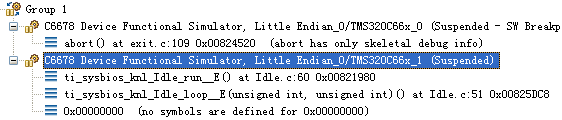

    but if I comment out MessageQ_registerHeap , MessageQ_create  , MessageQ_open  ,alloc, put and get. Only leaves HeapBufMP_create in test0 and HeapBufMP_open in test1.
    Then core0 can HeapBufMP_create normally , but core1 get stucked
    what's the matter?
