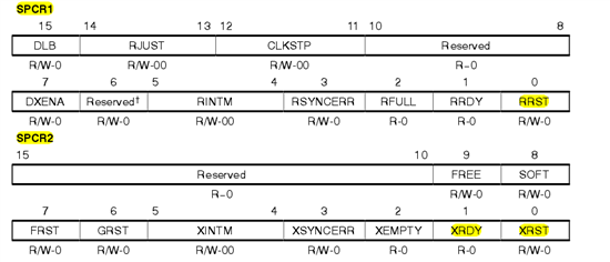

Q1: Why the
I2C_RSET(I2CCLKL,100);
I2C_RSET(I2CCLKH,100); set up after the
 I2C_setup(&I2Cinit);
If I set up the
I2C_RSET(I2CCLKH,100);  before the
I found that  through the I2C_getConfig(&testI2C); the value of I2CCLKH and I2CCLKL is 0x000f, not the 0x0064.

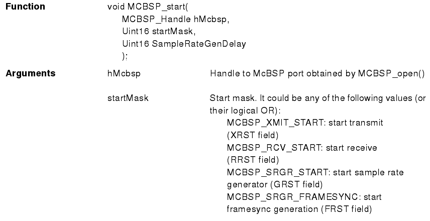

Q2: In the csl_mcbsp.h
#define MCBSP_RCV_START  (1u)
#define MCBSP_XMIT_START  (2u)
TMS320C55x Chip Support Library API Reference Guide
TMS320C55x DSP Multichannel Buffered Serial Port (McBSP) Reference Guide
From the above, after MCBSP_start, why the value of the bit is  RRST=1, XRST =1 and XRDY =1 , not the RRST=1, and XRST = 2 ?
Q3: What's the function of the OR in the MCBSP_start ?
MCBSP_start ( hMcbsp,
MCBSP_RCV_START | MCBSP_XMIT_START,
0);
