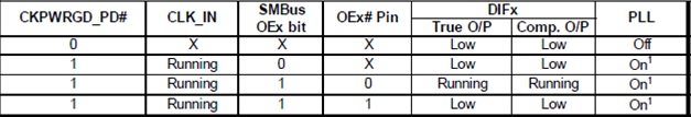

we would like to use 9DBV0431 as PCIECLK buffer but it does not have high-impedance state for output.
after checking the power management table as below.
Could we set the output pin of 9DBV0431 as LOW for PCIECLK  pin before CVDD is valid ?
or other suggestion would be appreciated.
