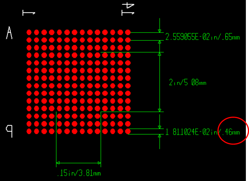

I got CAD data on TI web and confirmed pad dimension with TMS320C5517 ZCH package.
I feel pad dimension of ball is large for actual ball size.  Could you verify if this pad diimension is correct or not ?
Pad dimension of ball = 0.46mm
Package ball size = 0.36mm(min)/0.46mm(max)
In our experience, the pad dimension is not same as max size of ball, slightly smaller than ball size.
If you have any other document for pad design of this package, woud you please send me it ?
