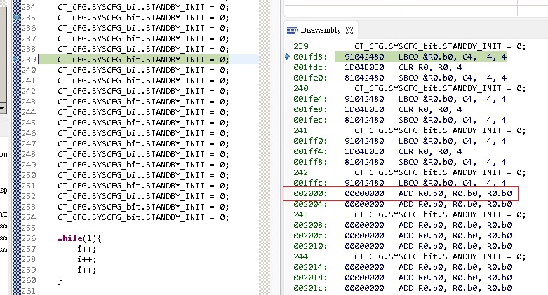

I am testing PRU-ICSS1 at AM437x Starter Kit.
I’m facing a problem with the program memory size. (PRU-ICSS1 - 12KB)
if my code size is over 0x02000, I'll see the error at "Disassembly window".
Please see the following photo.
Please help me.

    The AM437x PRU-ICSS1 Program memory physical size is indeed 12kB per PRU core. There is nothing that can be done about this. I don't understand what help is expected from TI.
  • Sorry, I didn't understand your question initially. Please disregard my previous post. I will ask the PRU experts to check this.
  • Check your software that is loading the PRU instruction memory that it is not capped at 8kB (old AM335x limit...).

  • I have replicated your issue on my AM437x GP EVM and CCS v6.1.3.
    It appears to be an issue where CCS has the wrong size for the PRU instruction RAMs in the files that specify the memory map of the AM437x/PRUs. I will notify the CCS team and let you know their response.
    Jason Reeder
  • The issue has been acknowledged by the CCS team and will be corrected in the next version of the Sitara device package that gets released.
    In the meantime you can do the following:
    • Close CCS
    • Replace the '<%ccs_install_dir%>/ccsv6/ccs_base/common/targetdb/devices/AM4378.xml' file with the one that I have attached which updates the PRU memory maps:

                              <property id="PRU Data RAM Offset" Type="hiddenfield" Value="0x2000" />
                              <property id="PRU Program RAM Size" Type="hiddenfield" Value="0x1000" />
                              <property id="PRU Data RAM Size" Type="hiddenfield" Value="0x1000" />
                              <property id="PRU Device Size" Type="hiddenfield" Value="0x100000" />
      						<!-- Project Wizard Settings -->
                              <property Type="stringfield" Value="true" id="IsElfDefault" />
                              <property Type="stringfield" Value="little" id="Endianness" />
      						<property Type="stringfield" Value="-D=am4378 -D=icss0 -D=pru1 --ram_model --silicon_version=3 --hardware_mac=on" id="CompilerBuildOptions" />
                              <property Type="stringfield" Value="--define=ICSS0_PRU_CORE=1 --stack_size=0x100 --heap_size=0x100" id="LinkerBuildOptions" />
                              <property Type="stringfield" Value="AM437x_PRU_SS0.cmd" id="LinkerCmd" />
      						<!-- END Project Wizard Settings -->
      						<!-- PRU Register sets -->
      						<property Type="filepathfield" Value="../../../emulation/gel/AM437x_PRU_ICSS0_local.gel" id="GEL File"/>
                              <instance href="../Modules/am437x/PRU_ICSS_INTC.xml" id="PRU_ICSS0_INTC" xml="PRU_ICSS_INTC.xml" xmlpath="../Modules/am437x/" description="INTC" baseaddr="0x00020000" size="0x2000" accessnumbytes="4" permissions="p" />
      						<instance href="../Modules/am437x/PRU_ICSS_PRU_CTRL.xml" id="PRU_ICSS0_PRU1_CTRL" xml="PRU_ICSS_PRU_CTRL.xml" xmlpath="../Modules/am437x/" description="PRU Control Registers" baseaddr="0x00024000" size="0x0080" accessnumbytes="4" permissions="p" />
      						<instance href="../Modules/am437x/PRU_ICSS_PRU_DEBUG.xml" id="PRU_ICSS0_PRU1_DEBUG" xml="PRU_ICSS_PRU_DEBUG.xml" xmlpath="../Modules/am437x/" description="PRU Debug Registers" baseaddr="0x00024400" size="0x0100" accessnumbytes="4" permissions="p" />
      						<instance href="../Modules/am437x/PRU_ICSS_CFG.xml" id="PRU_ICSS0_CFG" xml="PRU_ICSS_CFG.xml" xmlpath="../Modules/am437x/" description="CFG" baseaddr="0x00026000" size="0x2000" accessnumbytes="4" permissions="p" />
      						<instance href="../Modules/am437x/PRU_ICSS_IEP.xml" id="PRU_ICSS0_IEP" xml="PRU_ICSS_IEP.xml" xmlpath="../Modules/am437x/" description="IEP" baseaddr="0x0002e000" size="0x0400" accessnumbytes="4" permissions="p" />
                          </cpu>
                      </subpath>
                  </router>
              </subpath>
          </router>
      </device>
    • Delete the device cache in the hidden directory found in:
      • C:\Users\<username>\AppData\Local\Texas Instruments\CCS\<CCSV6 INSTALL FOLDER>\0\0 (on Windows)
      • ~/.ti/<CCSV6 INSTALL FOLDER>/0/0 (on Ubuntu)
      • You must first check this folder for a *.lic file. This is your license file. If you have one then you need to copy it somewhere safe
    • Restart CCS
      • If you had a *.lic file then CCS should ask you to point to its new location
    Once you restart CCS with the new AM4378.xml file in the correct place (after deleting the cache) then the code should load correctly. I've tested this on my machine and it works.
    Jason Reeder
  • Hi Jason,
    Problem solved!
    Thank you very much for your fast reply!
  • HI Jason,
    We are not sure that whether it has the same issue when PRU built in TOCTO by PRU Code Generation Tools v2.1.2, could you please clarify ? thanks.
  • The person who found the issue above was using v2.1.2 of the PRU C compiler.
    The problem was in the CCS configuration files. Not with the C compiler.
