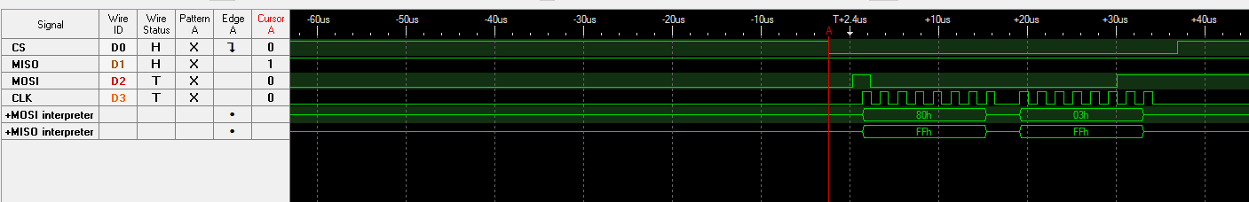

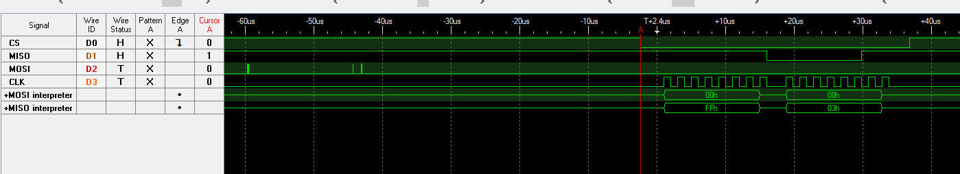

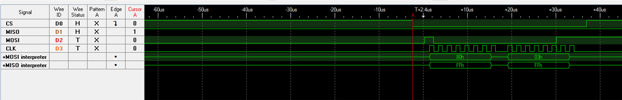

i can see the correct read back on my logic analyzer. but when i get the read backs in the buffer i get wrong values. for example in this test case Iam writing value three to address 0 to the device connected to spi.

below are my logic analyzer outputs for write and reds returning the correct values.
read command logic analyzer
Has anyone faced a similar problem where you see proper reads in the logic analyzer but the reads returns are wrong. Any suggestions can be appreciated.
