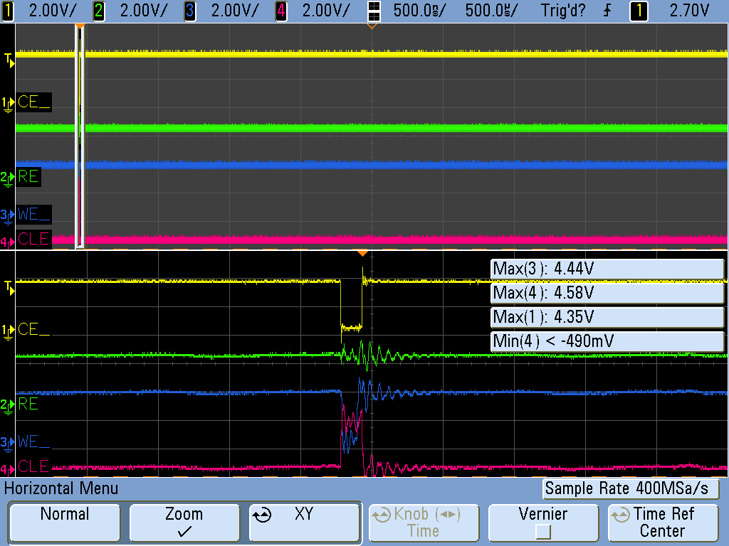

  •  Got more details from "radar"
    So the latest I have on this that I see the command getting strobed to the NAND on boot; but no read; as per the attached.  This is all executing from boot ROM… so if the boot ROM doesn’t try to read the NAND….not so clear to me it can make the assessment that the MLO header is wrong.   Doesn’t it HAVE to try to do a read?  All I see is a command…
  • One more...
    Checking the Linux core U-boot user’s guide, located here:
    processors.wiki.ti.com/.../Linux_Core_U-Boot_User's_Guide
    It references a dra7xx_evm_nandboot_config, which DOES NOT EXIST in the SDK. Now maybe it shouldn’t; because the EVM doesn’t have a parallel NAND...has it been tested?
    I don’t know how to make it not do the read. I’ve asked them to validate the RDY/B* (GPMC WAIT to you) is high once again, but I’m sure it is… without that being low, how do you make the AM572x not at least try the read?
  • All, so verified in the above plot; RDY/B# (GPMC_WAIT) is high throughout; so the EMIF is not being held off from attempting the read.  That said, I'm out of ideas save attaching JTAG and tryignto setp through the ROM code; but in order to do that I'd need some support from the ROM code experts (like a symbol table/.out file).
    But bottom line- using NAND boot, what we are seeing is documented above- we see a command get strobed to the NAND but no read attempt at all.  The logger says we are at a state where no valid GP header was detected; to which I would agree- if you don't attempt the read it's not going to find it.  Send help!

  • All,
    We are able to get the NAND boot to work.
    We changed "NAND_D11/BOOTMODE11" pin value to logic high level(means A/D mux mode for NAND).
    Thanks for the help!
