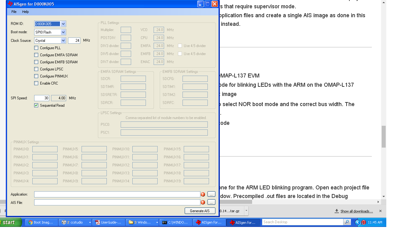

    I HAVE THE AIS GENTOOL THAT IS AS BELOW NOW HOW TO GENERATED THE AIS FOR ARM  USING THIS /OR CAN WE USE SOME COMMAND LINE OPTION FOR GENERATING ARM UBL.BIN
      nEED HELP ON THIS IS THE TOOL THAT I AM USING IS OLDER VERSION OR IF THIS IS COMPATIBLE TO GET IMAGE ON ARM KINDLY LET ME KNOW HOW TO DO THAT

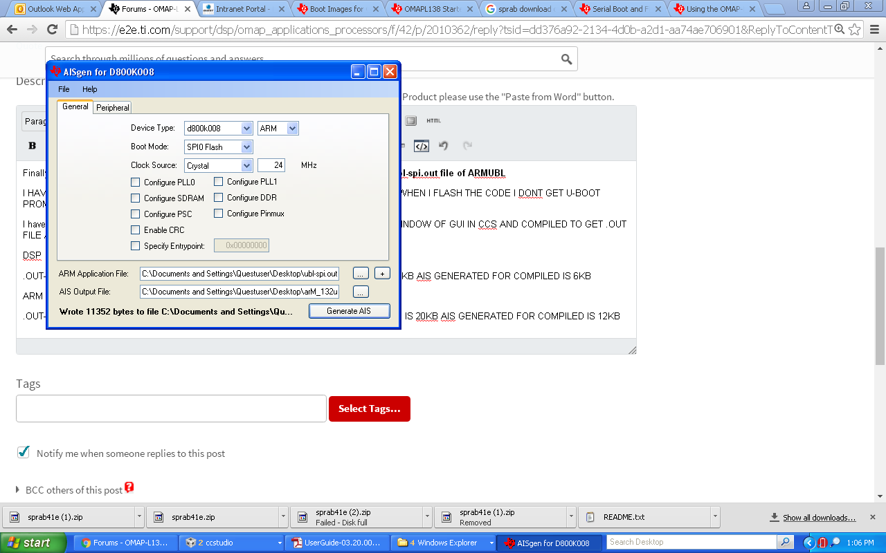

  • Finally with lots of experiment I have been held up in the final step of .bin generation from ubl-spi.out file of ARMUBL
    I HAVE USED THE TOOL THAT I HAVE ATTACHED AND GENERATED THE ARM.BIN FILE ,BUT WHEN I FLASH THE CODE I DONT GET U-BOOT PROMPT
    I have not modified the source code i have just changed the SPI_BOOT MODE IN MANAGE WINDOW OF GUI IN CCS AND COMPILED TO GET .OUT FILE AND PROVIDED TO AIS GENERATOR FOR BIN FILE AS ABOVE
    DSP
    SOURCECODE COMPILED--->.OUT--->AIS-DSPMODE------>.BIN--->SPIWRITER--->WORKING ----------PREBUILT IMAGE SIZE IS 6 KB
    AIS GENERATED FOR COMPILED IS 6KB
    ARM
    SOURCECODE COMPILED--->.OUT---->AIS-ARMMODE----->.BIN--->SPI WRITER-->NOT WORKING ---------PREBUILT IMAGE SIZE IS 20KB
    AIS GENERATED FOR COMPILED IS 12KB
    NOT SURE WHATS THE CAUSE FOR THIS! HELP REQUIRED ASAP!

    Finally able to get a alternative solution for the building of the ARM.BIN file
    NOTE:the ccsv 5/6/4 sometimes dosent build the .bin bin file so
    kindly make sure you get the .out file first and and check for the hex470.exe in my case path in the installation directory
    and try to build the .bin file from the command prompt
    For example I have added the commands :
    hex470.exe C:\Users\1011467\Desktop\armubl-03.20.00.14.tar\armubl-03.20.00.14\ubl2bin.cmd -o C:\Users\1011467\Desktop\Arm\ubl-omapl1x7\ubl-spi.bin C:\Users\1011467\Desktop\Arm\ubl-omapl1x7\ubl-spi.out
    hex470.exe C:\Users\1011467\Desktop\EVALUATION_BOARD_SOFTWARE\DaVinci-PSP-SDK-03.20.00.13\src\boot-strap\ARM\armubl-03.20.00.13\ubl2bin.cmd -o C:\Users\1011467\Desktop\ARM_2\ubl-omapl1x7\ARM_2.bin C:\Users\1011467\Desktop\ARM_2\ubl-omapl1x7\ubl-spi.out
