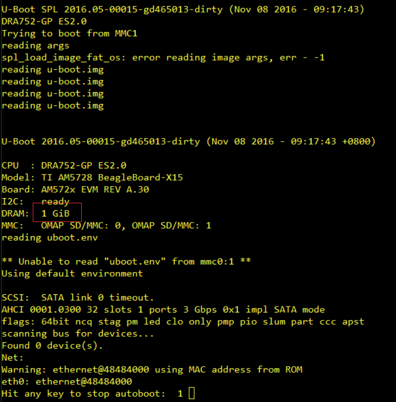

Now the problem is that the ddr3 on beagle_x15 board is 2GiB(the default configuration on the u-boot is 2GiB too),when I use the u-boot boot up the board that has 2GiB DDR3,the capacity detection is ok,and it will show me that the ddr is 2GiB.But when it use it boot up the board that with 1GiB,it also shows me that the ddr is 2GiB.So I change the struct dmm_lisa_map_regs on the board/ti/am57xx/board.c file like that:

After do that,I got the right result。

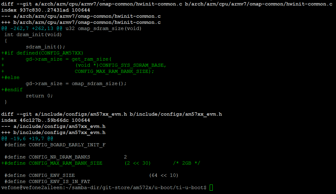

I don't want to use two u-boot,which is one for 1GiB DDR3,and the other one for 2GiB DDR3.How should I do ?How to modify the u-boot ?so the u-boot works on 1GiB ddr3,and it shows me that the capacity of ddr is 1GiB.When it  works on 2GiB ddr3,and it shows me that the capacity of ddr is 2GiB.
