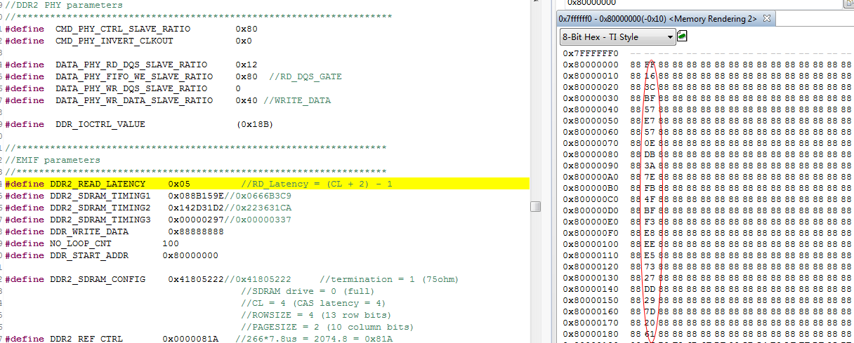

1.the launch pad is AM3359 ,the DDR2 is MT47H32M16HR-25E.
2.Below is my configuration,and I just read &write the data in the file of GEL . I Just Set 0X88 to the DDR2.
3.Problem is :all the place the last address number is 1, the data  have changed ,when I read the data from DDR2,
