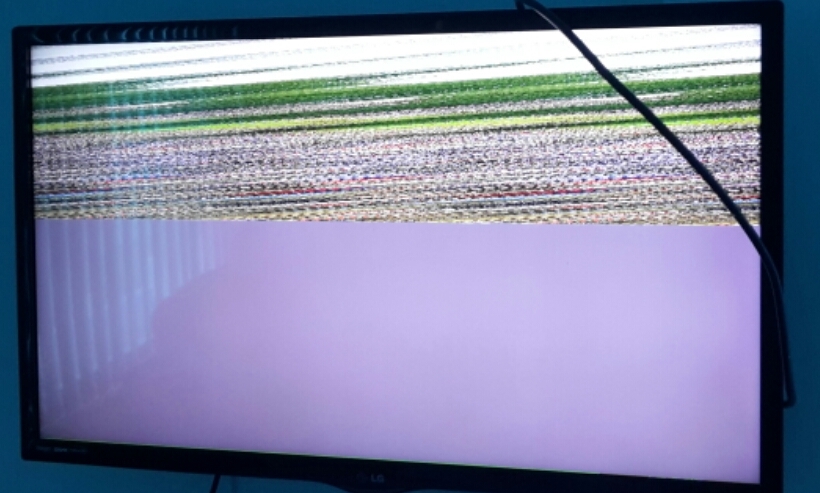

I compiled and burned Vision SDK to emmc and booted from JVM5777 board.
I am getting root console in debug terminal but nothing is shown in LCD Display?
Currently i don't have Vision board or Cameras ,i think the board wont take normal webcams.
Does the Linux OS has an X server running for display control?

  • Hi ,
    The first problem is nothing is displayed in LCD.
    Does the NullSrc example only require bitstream video file only. How should i pass the video file to the program? What does the index file means?

  • Hi Shiju,
    Now the program is not giving any ASSERT message, its running but still nothing is displayed in LCD or HDMI
    5

    [HOST] [IPU2 ] 101.680259 s: DECODE: ERROR: ALGPROCESS FAILED (status=0x00000a10) !!!
    [HOST] [IPU2 ] 101.680381 s: DEC_LINK: outArgs->viddec3OutArgs.extendedError for channel 0 Error: 0xa10
    [HOST] [IPU2 ] 101.680473 s: DEC_LINK: Sequence called number 27
    [HOST] [IPU2 ] 101.764777 s: DECODE: ERROR: ALGPROCESS FAILED (status=0x00000401) !!!
    [HOST] [IPU2 ] 101.764899 s: DEC_LINK: outArgs->viddec3OutArgs.extendedError for channel 0 Error: 0x401
    [HOST] [IPU2 ] 101.765021 s: DEC_LINK: Sequence called number 29
    [HOST] [IPU2 ] 101.862258 s: DECODE: ERROR: ALGPROCESS FAILED (status=0x00000401) !!!
    [HOST] [IPU2 ] 101.862380 s: DEC_LINK: outArgs->viddec3OutArgs.extendedError for channel 0 Error: 0x401
    [HOST] [IPU2 ] 101.862471 s: DEC_LINK: Sequence called number 32
    [HOST] [IPU2 ] 101.994784 s: DECODE: ERROR: ALGPROCESS FAILED (status=0x00000401) !!!
    [HOST] [IPU2 ] 101.994906 s: DEC_LINK: outArgs->viddec3OutArgs.extendedError for channel 0 Error: 0x401
    [HOST] [IPU2 ] 101.995028 s: DEC_LINK: Sequence called number 36

  • Hi Shiju,
    When i use 1280x7200_00.h264 i am getting some colors on TV can't see the video. Do i need to change any other setting?
