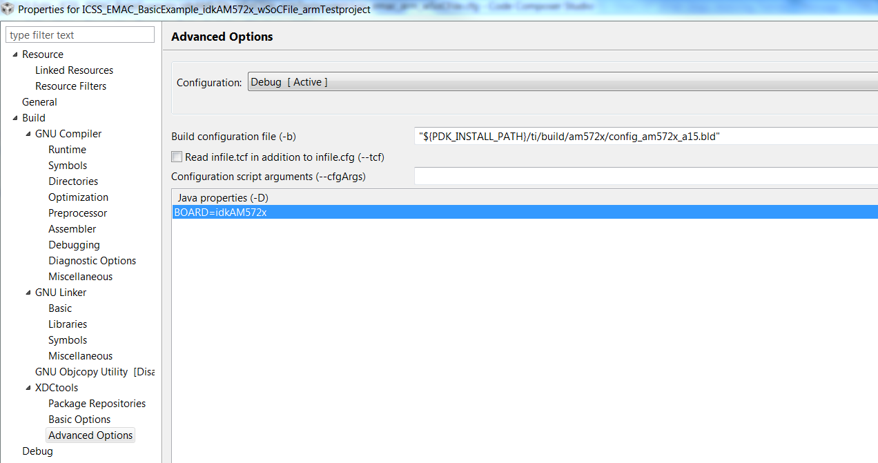

  • Hi Sylvain, understand your concern, please check/modify "config_am572x_a15.bld" to fit your project needs. Maybe you can try a quick (and dirty) include as-is for a quick test, just to see if it works
    thank you,

  • Hi Paula,
    It seems as if I want to use "config_am572x_a15.bld" then I need to completely rebuild my project from scratch. Is there any other way to link the new PRU binary as before? This is just a linking problem to make an upgrade for a fix in the PRU. I would rather use the old header file mechanism, less risky and quicker to integrate. I feel like I getting into something bigger than it needs to be. I will comeback to this issue on Monday morning, hopefully you can provide me an easier upgrade path by then.

  • Hi Sylvain, you are right, we can just change where to locate in memory "PRU0_REV2_XX" inside "lnk_a8_a9_a15_REV2.cmd". We can try to use where you current dataMemory is.
    Just say, you used "EXT_RAM" name for data memory section (please check on your linker.cmd) then, you just need to change in lnk_a8_a9_a15_REV2.cmd:
    > APP_CACHED_DATA_BLK1_MEM
    to
    > EXT_RAM
    let me know if this works.
