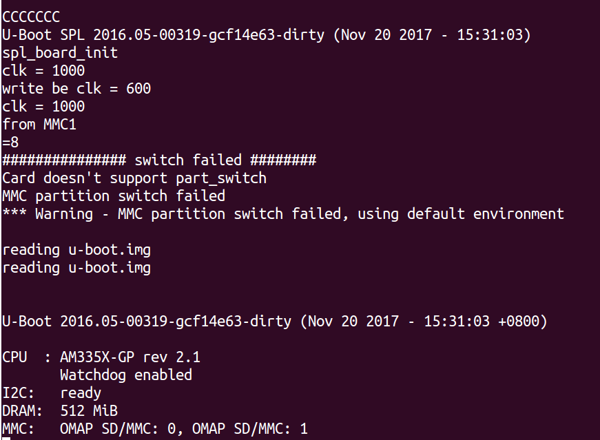

AM3354: Setting 600MHz MPU frequency in U-boot
Part Number: AM3354
Other Parts Discussed in Thread: TPS65217
SDK :  ti-processor-sdk-linux-am335x-evm-03.03.00.04-Linux-x86-Install.bin
Compile the file: am335x_boneblack_defconfig
Power chip:  TPS65217DRSL
am3354 hardware voltage value :  VDDS_DDR 1.35V,    VDD_MPU 1.01V,   VDD_CORE 1.101V , Clock crystal : 24MHZ
The purpose is to configure VDDS_DDR to 1.35V, 1.01V to VDD_MPU, 1.101V to VDD_CORE to 600M during uboot.
am3354 run to the following location card will be powered down:
The test found that uboot stage power-down chip power supply card.
dpll_mpu_opp100.m = am335x_get_efuse_mpu_max_freq(cdev);   //read  dpll_mpu_opp100.m is 1000MHZ
dpll_mpu_opp100.m = MPUPLL_M_600;  // dpll_mpu_opp100.m is 600MHZ
do_setup_dpll(&dpll_mpu_regs, &dpll_mpu_opp100);
dpll_mpu_opp100.m = am335x_get_efuse_mpu_max_freq(cdev);  //After setting read dpll_mpu_opp100.m value is still 1000MHZ
How to set the MPU frequency to 600M  ??

    Thank you for sending the connection, I've seen it, but it doesn't help much.
    In board/ti/am335x/board.c :
    I set VDDS_DDR 1.35V, VDD_MPU 1.01V, VDD_CORE 1.101V . By reading back registers, these voltage values are configured correctly.
    However, the MPU frequency is set to 600MHZ, and the read back is 1000MHZ.
    I set the method as follows:
    dpll_mpu_opp100.m = MPUPLL_M_600; // set dpll_mpu_opp100.m is 600MHZ
    struct dpll_params dpll_mpu_opp100 = {
    600, OSC-1, 1, -1, -1, -1, -1}; // OSC is 24
    const struct dpll_params dpll_core_opp100 = {
    600, OSC-1, -1, -1, 10, 8, 4}; //OSC is 24
    do_setup_dpll(&dpll_core_regs, &dpll_core_opp100);
    The value read through am335x_get_efuse_mpu_max_freq(cdev) is still 1000MHZ.
    What's wrong with my method?
    This problem has been bothering me for several days, and I hope you can help me. Thank you.
    BR,
    Andre

    am335x_get_efuse_mpu_max_freq() function returns the MAX possible MPU frequency that is supported for the specific device part. This function is located in the below file:
    u-boot/arch/arm/cpu/armv7/am33xx/sys_info.c
    As you do not modify that function, it will always return the same result (1000MHz - the max frequency supported for your device).
    The correct approach for you is to dump the MPU DPLL registers to verify 600Mhz are setup correctly, not reading again the value returned from the am335x_get_efuse_mpu_max_freq. This is fully explained in the e2e thread I have provided.

  • andre feng said:
    VDD_MPU 1.01V
    You still do not provide your AM335x device part number as requested, but in all cases VDD_MPU to work at 600MHz/OPP100, should be 1.100V nominal, 1.056V minimum. It can not be 1.01V. See AM335x datasheet, 5.4 Operating Performance Points (OPPs)
