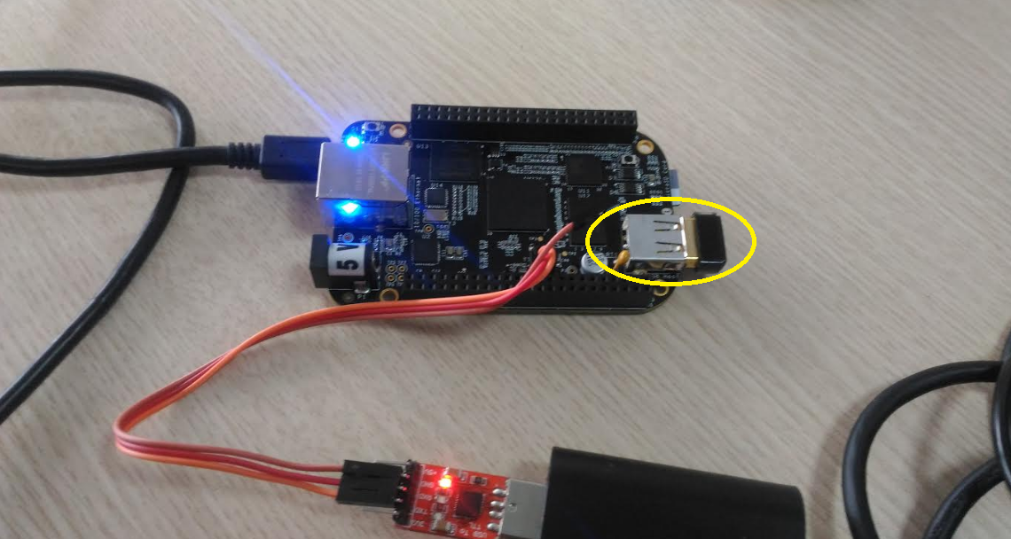

Hi community!
I was following instruction on docs Quick Start Guide (HAP AV7L). I have problem on step "Enable Wifi" I tried to connect to Wifi (Setup on wpa_supplicant.conf) but it's always complain "Could not read interface wlan0 flags: No such device"
P/S: I'm using BeagleBone Black Board

    I'm using "PROCESSOR-SDK-LINUX-AM335X 03_02_00_05" (64 bit binary)
    I have TP-link USB Wifi adapter, but my beagle bone board does not recognize it.
    By the way: How can I do that "Has the ./load_wlcore.sh script successfully loaded the "wl18xx" and "wlcore_sdio" modules" in the instruction do not have this step
    Best Regard,
    Minh Son
  • Can you post the output of lsusb command executed from the BBB console while the TP-link USB Wifi adapter is attached?
  • Hi Kemal!
    Here is the result (I'm using TP-Link Wifi USB WN725N)
    root@am335x-evm: ~# lsusb
    Bus 001 Device 002: ID 0bda: 8179 Realtek Semiconductor Corp. RTL8188EUS 802.11n Wireless Network Adapter
    Bus 001 Device 001: ID 1d6b:0002 Linux Foundation

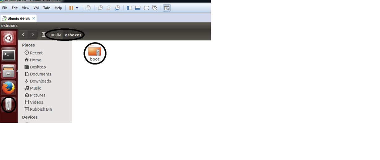

  • These two paths "/media/<username>/boot/" and "/media/<username>/rootfs/" are on your host machine. They are the two partitions of your SD card. Attach the SD card to your host machine these two partitions will be created and mounted automatically, then copy the needed files. Refer to the targetNFS directory hierarchy, the structure on your SD card and lib/modules/4.4.32-gadde2ca9f8 should be the same.
  • Hi Kemal!
    On my host machine just display "boot" folder, I do not see folder "rootfs".
    I tried to create custom folder "rootfs" on host machine and use the commands "sudo scp -r..." to copy, but when I do the command "root@am57xx-evm:~# modprobe rtl8192cu" on beagle bone, it's not work and display "modprobe: FATAL: Module rtl8192cu not found in directory /lib/modules/4.4.32-gadde2ca9f8"

    How about the folder "rootfs" on host machine?, I cannot find it
  • The "rootfs" on host machine is the second partition of the SD card.
