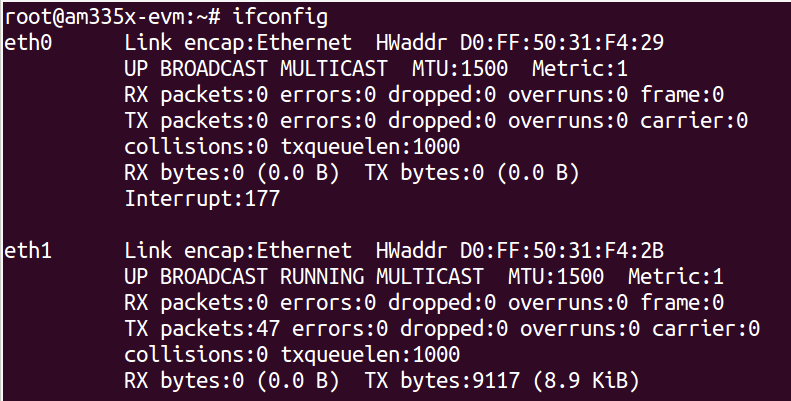

AM3354: Cannot get network address
Part Number: AM3354
Main chip : AM3354BZCZ100
Network chip : KSZ9031RNXCC
SDK: RT-3.3             Device Tree :  am335x-boneblack.dtb

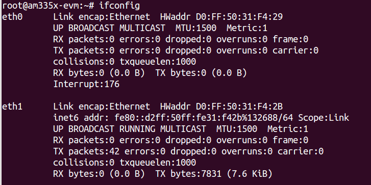

There is a problem: ifconfig or udhcpc-i eth0 can not get the network address.

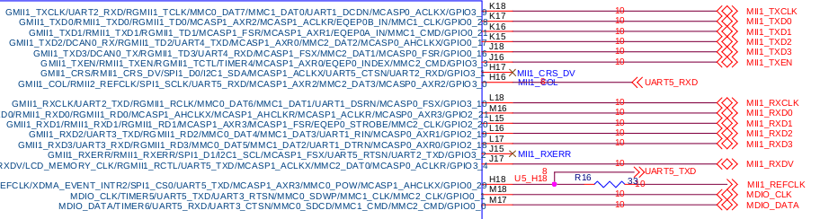

The hardware connection is as follows:
The device tree is as follows:

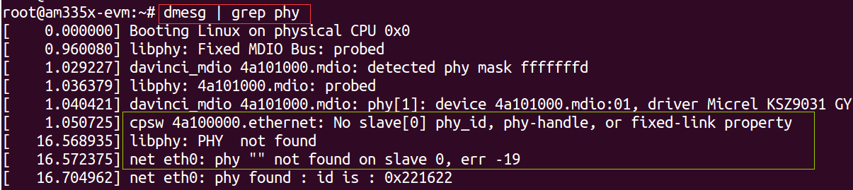

&cpsw_emac1 {
  phy_id = <&davinci_mdio>, <1>;
  phy-mode = "mii";
  status = "okay";

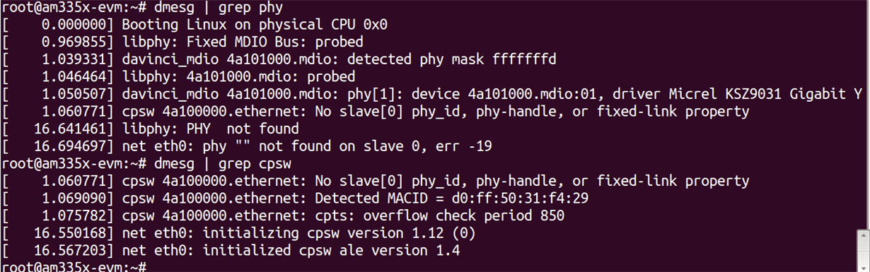

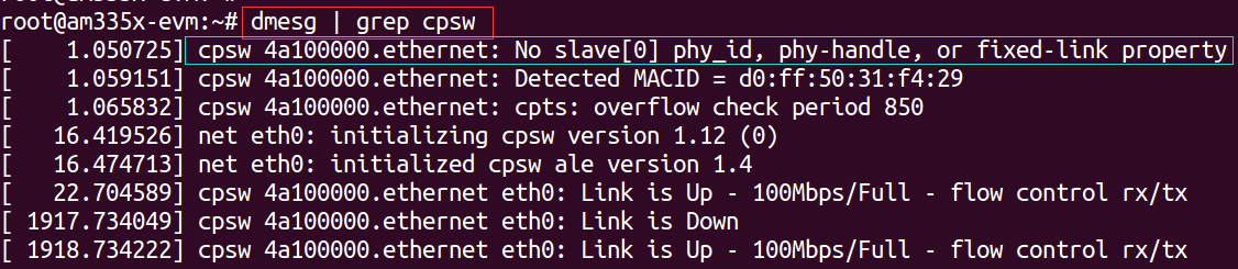

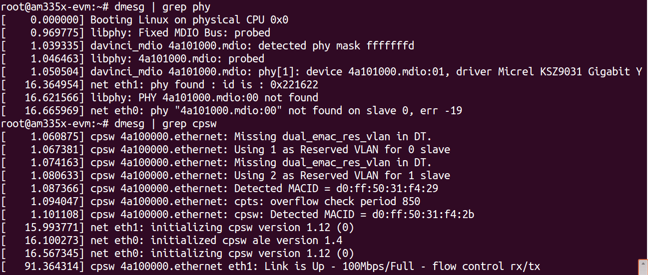

Kernel printing information is as follows:

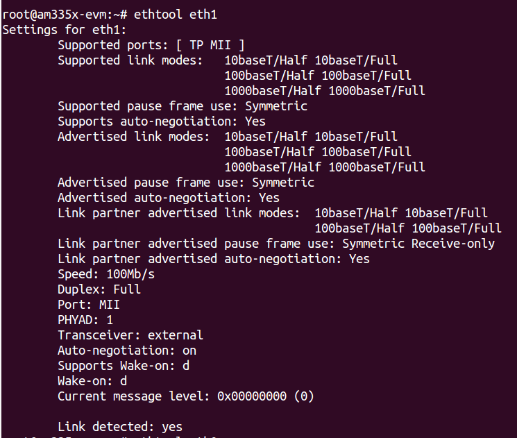

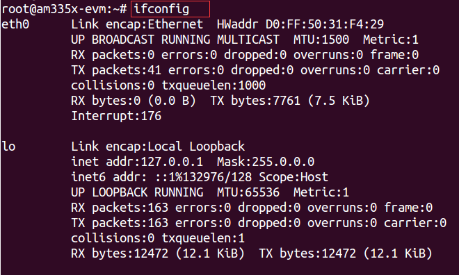

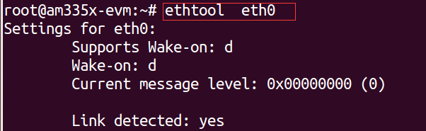

Execute the corresponding command:
How to solve the problem of not getting network address  ?
Hope to get your help.
