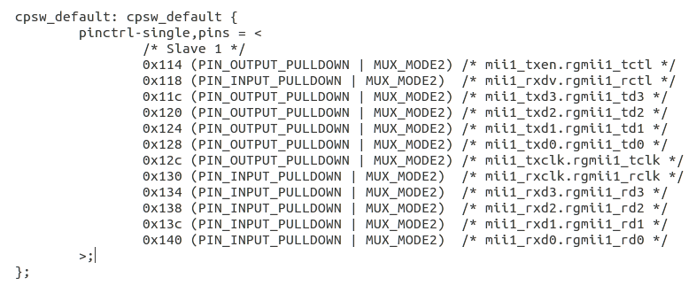

The definition of pins about cpsw in the am335x-evm.dts:
But I can't find the definition of pins about cpsw in the dra7x-evm.dts
