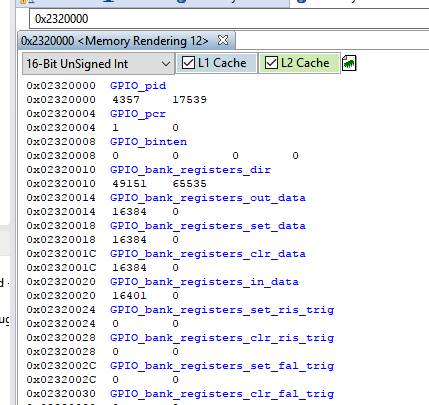

Every time I browse any memory, whether SRAM,  or MMR space, the following immediately appears in the CC7 Console:
As you can see- this memory was the GPIO configuration MMRs.   If i go back and look at the memory window, it seems to show proper values in the MMRs:
Same happens with L2 SRAM.  I ran at test to program values into it.  The test then Writes back from L1D, invalidates the test region, then reads back from L2 and all values match.   If I  browse the L2 SRAM, I immediately get the console message    Error ....  0x   002/-1176 ...   .    But going back to the memory browser  I see the proper results....

  • My colleague just walked into the lab with a brand new XDS110 Debug probe recommending I try it. I down loaded & installed the latest driver for XDS110 from T.I. and plugged this in. After a few hiccups, it connected to my custom C6657-based PCB.
    Debugging with this probe, the memory problems are gone! I can inspect all memory without the running list of cryptic errors filling up the console. In the memory browsers, I can un-check L1D and see accurate representations of all memory resources, rather than "???? ????".
    So looks like the problem was one of two things:
    - The XDS 510 USB selection in the Target Configuration should not have given a drop-down choice to use with C6657
    - or perhaps there's a new device driver + F/W needed for this older XDS 510.
