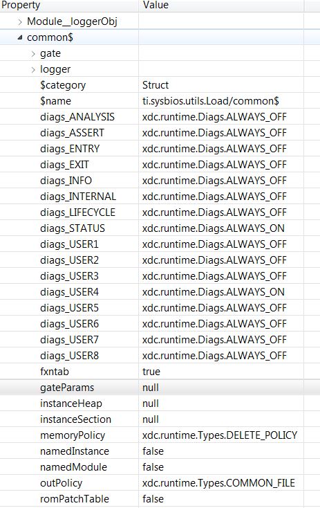

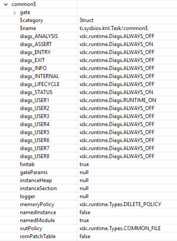

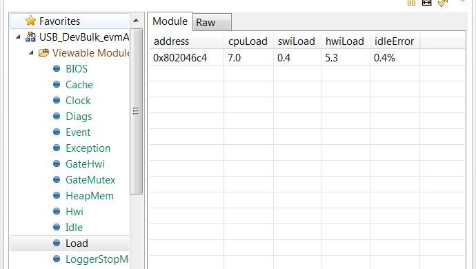

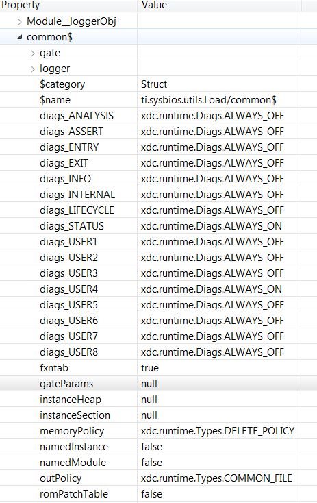

    I did a quick diff of the SYS/BIOS and UIA versions you have listed. Nothing jumped out to explain the issue. On the customer's setup can you get a snapshot of ROV->Load->Raw->Configuration->common$. It will look something like this.
    I want to see what the target has configured.
    Also, what does ROV->Load->Module show?
    Todd

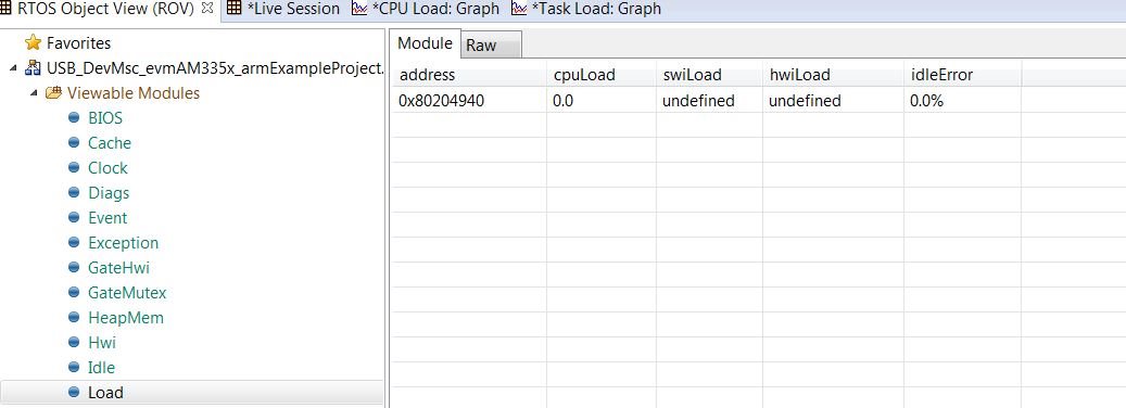

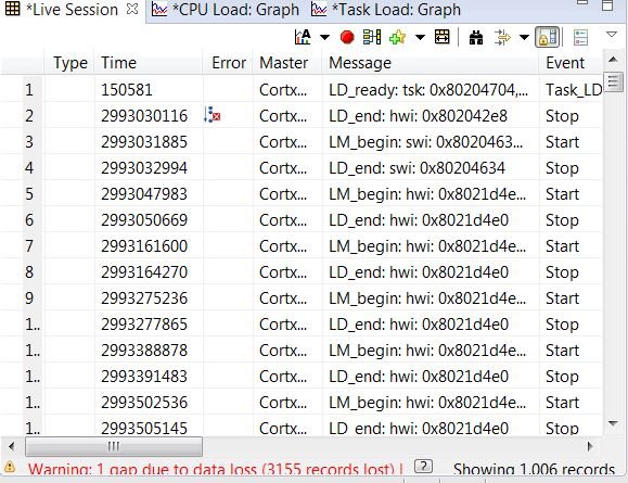

    Thanks for the help! I attached several pics for the failure cases and working cases:
    Failure:
    1) I saw a gap of data loss
    CPU load is 0%
    Working case:
    I still see data loss in live session (no pic attached)
    CPU load is no zero, also reflected in CPU load graph
    Regards, Eric
  • Edit to the previous post, the correct one is in the working case, I still saw the gap of data loss
