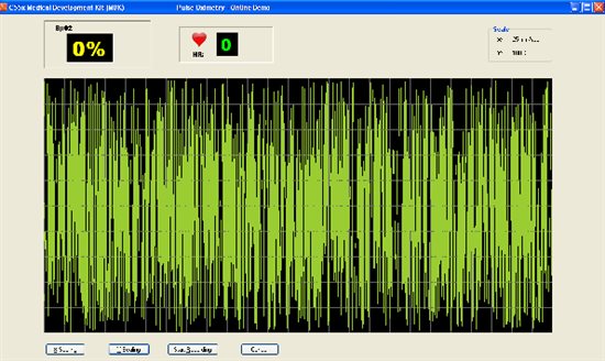

I am working with TI's pulse oximeter. I have 2 doubts:
1) When i connect EVM 5505 board to my laptop and run the pulse oximeter , i am only able to look at the signal on the LCD , the %SPO2 and HR are being shown as 0. I am not sure whats wrong ? Even the PPG signal looks some what random when compared to what is shown in the PDF file provided with the kit.
2) how do i extract the PPG signal into MATLAB ? Is there any way to save it into txt file and use it in MATLAB?
I would really appreciate if anyone could help me with these questions.

  • Hello Mr.Chung,
    I have problem with the board again. I worked with the board yesterday. I see the same random signal again. I don't find any difference between the random signal shown by the new board compared to the old board. I tried runing the SPO2 system files, but at the end it was throwing some random signal. I would really appreciate if you can please figure out the problem.
    Kali.

  • Specifically, the trouble that we are getting is that the output is just noise.  No heartbeat pictures like in the pdf; no SpO2 or HR readings.  Below is what it looks like.  The red noise occurs just after we insert our finger into the probe:
    Berwyn

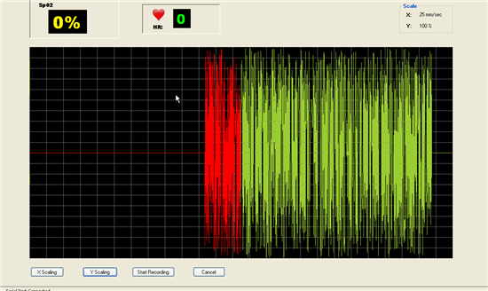

  • Hello mr Chung!
    I have the same problem that Kali has with the spo2 module. What is the failure detected in this boards?
    I am working with the evm5505 and code composer 3.3
  • Hi Peter,
    I purchased a SpO2 system last week. I am using EVM5515 , SpO2 AFE board, Biometric sensors and latest softwares. Everything is working properly but I am getting a noisy signal and it does not show the SpO2 and HR. I have tested 2 Biometric cables sensor(recommended ones) and Nelcor and Philips product as well.
    You can see what I am getting at the end of this letter.
    It seems that my board SpO2 AFE board is also faulty as other members of this community has faced.  Please let me know how I can solve this issue.
    Rasoul

    I need help with my pulse oximetry FE. I am using 5515EVM , SpO2 AFE board, Biometric sensors like Rasoul Yousefi. I had the same problem but I could solve it. Now, I have a signal without noise but I haven't %SpO2 and Heart Rate on the OLED. Once I had a %SpO2 ( the first time, but it was incorrect, about 178%).  Which is the problem? How can I check if my board is correct?
    I have a SpO2 FE Rev 4 and a TMS320C5515EVM Rev B. My sensor is 020101001.
