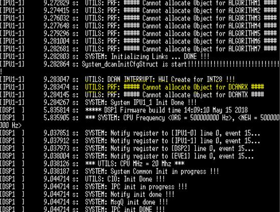

  • Hi, Vivek. thank for your reply :).
    sdk version i use is version 03.02.
    i just want to receive can data including CAN id, DLC, IDE, DATA etc.
    also i transmit can data through EasySync(Can Bus Program) and i check print msg from TDA3xx to UART.
    As i told you, i did change 0U -> 1 in system_dcan.c
    /** \brief Used for enabling board-to-board DCAN */
    #define ENABLE_B2B_DCAN_TEST (1)
    and i transmit CAN id "C1", DLC "8" and data "1111111111111111" using EasySync.
    but i could not check any print msg.
    Are there another things that i have to in besides above action?
    i don't know how i'm using dcan lib(system_dcan.c, utils_dcan.c, utils_dcan.h) exactly.
    i would like to get more information about dcan to finish my project.
    for example, i don't know whether one of dcan function in lib has to be in While loop.
    dcan.zip
    thank you.
    TODAY there is plus posting about dcan.
    i found this printf message, UTILS: PRF: #####Cannot allocate object for DCANRX ####.
    i don't know why this message is shown.
    Could i give this plus question Vivek?

  • Hi, Vivek.
    yes, i've already changed make file on  what you said.
    I can check Loopback mode of dcan.
    but Normal mode can't.
    there is solution on this case?

  • Hi Vivek,
    if i do As you told you, CAN LOOPBACK is OKAY, but CAN NOMAL is not.
    I don't know why it doesn't work.
    if i transmit CAN SIGNAL to TDA3 board, it happens CAN BUS OFF ERROR!
    I check pin mux, CROSSBAR something like that.
    I can't find right way.
    Is there anything else to get some help?
