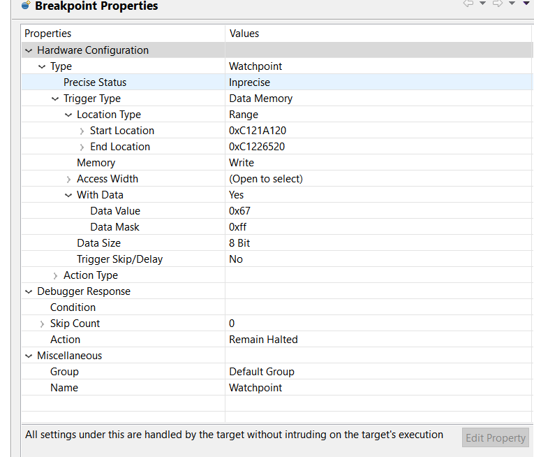

  • You are right, I tried to reproduce it for the same mask and failed.
    But the problem is still there , I putted a watch point at aligned image for memory write with 8 bit , vlaue = 103
    VLIB_createCCMap8Bit wrote this value for the following mask
    with minArea = 500,  (it should have at max value = 2 , just tow regions are bigger than 500)
    the problem occurs maybe due to low level optimizations or something like that.
    for a workaround, I just looped the aligned image and put zero whrere value > 10
    Can I help with additional information ?
  • My system has timer inttrupt 2000 times / sec, maybe this affect the VLIB_createCCMap8Bit somehow ?
    The watchpoint triggered at VLIB_createCCMap8Bit  +  0x1B4

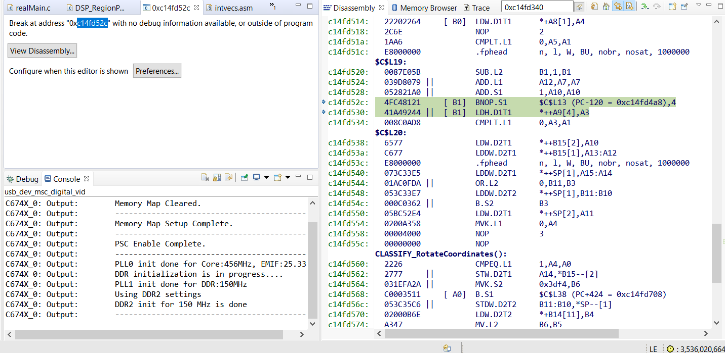

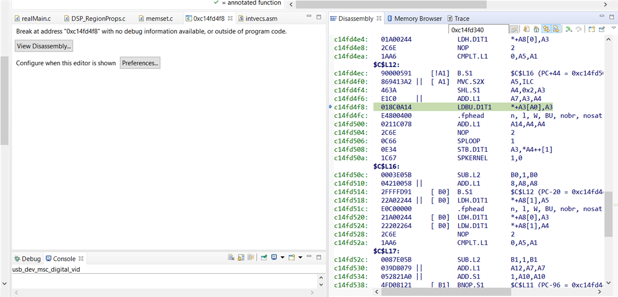

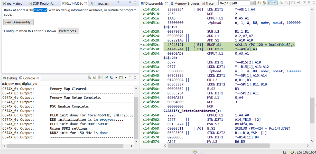

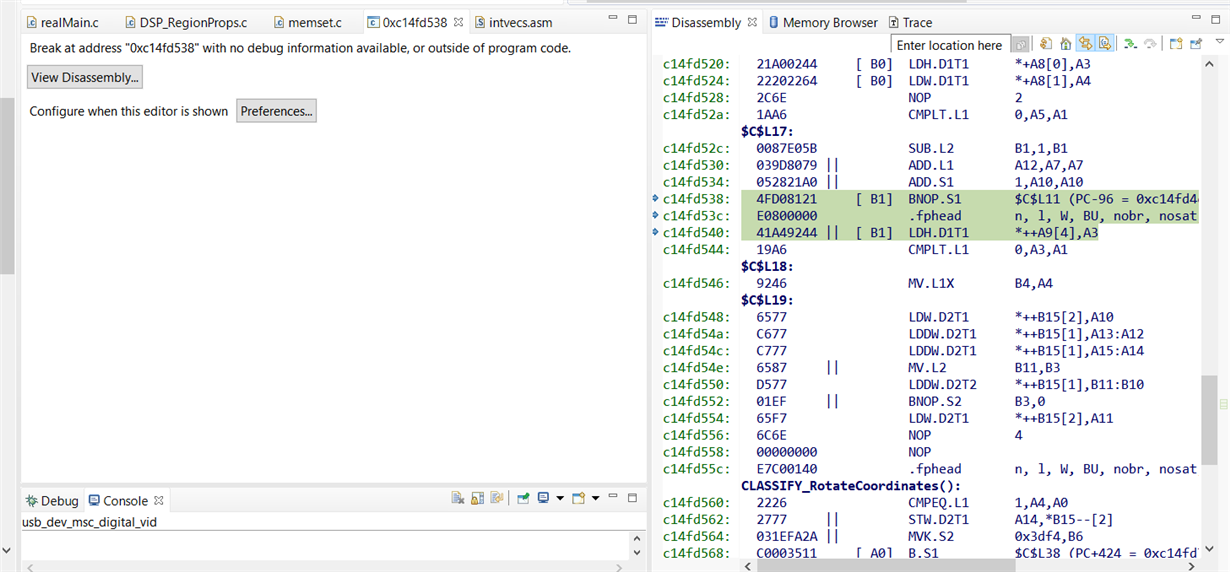

  • Here is a screenshot : (with watchpoint)
    memory map :
    c14fd340    00000220     vlib.ae674 : VLIB_createCCMap8Bit.oe674 (.text:optimized)
    cn version :
    c14fd340    00000220     vlib_cn.ae674 : VLIB_createCCMap8Bit_cn.oe674 (.text)
  • Mohammad,
    I hope you had a good Eid al-Fitr.
    Thanks for sending your screenshots.  There are a few ideas I had when I saw them.
    1. I noticed that the watchpoint was triggered on LOAD instructions.  If the watchpoint tool is accurate (the imprecise word in the window makes me wonder if it is accurate), then this seems to mean that the memory is written because of a LOAD (READ) instruction.  Since this doesn't initially make sense, this makes me think about it being perhaps a cache-line eviction.  When a read request comes to a new cache line boundary, and it is a cache miss, then the cache line needs to be fetched from memory, while a different cache line needs to be evicted in order to make room.  If the cache is set to write-back policy, then this eviction may trigger a write back at that time before performing the cache line read.  Is it possible that there is some cache line boundary misalignment happening here?
    2. Is there some other DMA in the system that might be overwriting some cache/RAM boundary?
    3. Can you ensure that your  buffers are allocated according to multiples of cache lines (I think 32 bytes, but you should check the spec for your DSP).
    4. Could it be possible that there is some buffer overruns happening from other processes/tasks/interrupts that could be overwriting this memory such that when the cache line is evicted, it shows up back in the buffer?
    5. Perhaps try to narrow down the problem by either disabling the interrupts all-together, or at least disabling them while in this function (disable interrupts before entering the function, and re-enabling them after exiting this function).
    6. Perhaps try to narrow down the problem by disabling the cache to see if this gives any clues (this would probably slow things down too much, but may give some interesting data point if it happens still or not).
    It is difficult for me to debug this issue as it seems to be something specific to your full system setup since it is not reproducible in a simple stand-alone test, so the best I can do right now is offer some ideas for you to try out.
    Jesse

  • Can you please run the functions on random input and then check :
    for(x = 0; x < 224 * 224 ; x++)
    if(aligned_image[x] > number of found blobs)
    breakpoint here
    So you can find when this bug happens ?
  • Okay, this test was a good suggestion.  With it I was able for the first time to reproduce your problem and see the failure.  I will spend some time on this tomorrow to debug and find the source of the problem
    Thanks,.
    Jesse
  • Mohammad,
    I was able to find the root cause and resolve the issue. I can work on getting an updated release next week. Before I do, I was wanting to check if your project would have issues linking the library compiled against C6000 compiler version 8.2.4, as we have been updating our latest releases to use this. I'm not sure which compiler version you are using and if version 8.2.x would work okay for you.
