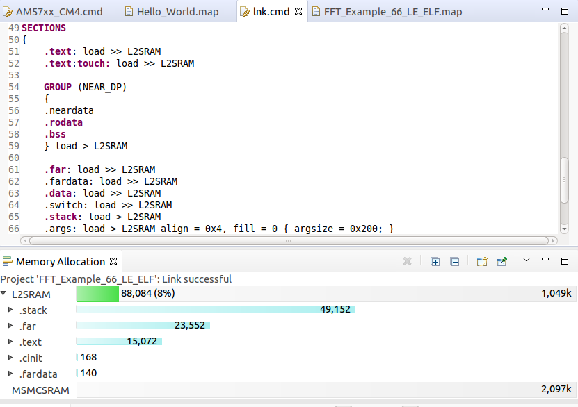

  • Hey Sahin,
    That makes a lot of sense.  Incidentally, regarding the use of GEL files, it wasn't until I discovered and installed the XDS Emulation Software package into ccs_base of Code Composer Studio that I had any GEL files available to me such as /ccsv7/ccs_base/emulation/boards/am572x/gel/AM572x_cortexM4_startup.gel.  I see some application examples have their own .gel files and I presume they should be used in preference to the more general ones when they're present.
    Thanks also for that CCS Files link - it's really useful,
    One last thing - I had been assuming that a DSP or IPU image loaded by Linux will be placed into the CMA carveout as defined in the device tree - I'm starting to think that's a little over-simplistic now?  I guess the linker .map file is answering that particular question for me but it's actually making me a little more confused.
    Here's an extract from the .map file from one of the DSP examples I just built and it appears to be using GPMC space (0x00000000 to 0x1FFFFFFF) as opposed to DDR memory controller space (where the CMA carveouts would be) - although the L2SRAM name suggests otherwise:
    OUTPUT FILE NAME:   <FFT_Example_66_LE_ELF.out>
    ENTRY POINT SYMBOL: "_c_int00"  address: 00815460
    MEMORY CONFIGURATION
            name            origin    length      used     unused   attr    fill
     L2SRAM                00800000   00100000  00015814  000ea7ec  RW X
     MSMCSRAM              0c000000   00200000  00000000  00200000  RW X
    The value of 0x00800000 for the origin of L2SRAM is what's confusing me here since that appears to be in the range of GPMC space unless I'm interpreting those number wrong.
    Any light that you can shed on this would be a huge help!  In the meantime, I'll be reading through that CCS Files link in more detail.
    Dermot

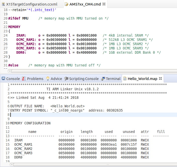

  • Hi Sahin,
    Well from looking at the linker command file associated with a simple "Hello World" project...
    #ifdef MMU     /* memory map with MMU turned on */
    MEMORY
       IRAM:      o = 0x00000000 l = 0x00001000   /* 4kB internal SRAM */
       OCMC_RAM1: o = 0x00300000 l = 0x00080000   /* 512kB L3 OCMC SRAM1 */
       OCMC_RAM2: o = 0x00400000 l = 0x00100000   /* 1MB L3 OCMC SRAM2 */
       OCMC_RAM3: o = 0x00500000 l = 0x00100000   /* 1MB L3 OCMC SRAM3 */
       DDR0:      o = 0x80000000 l = 0x40000000   /* 1GB external DDR Bank 0 */
    #else     /* memory map with MMU turned off */
    MEMORY
       OCMC_RAM1: o = 0x40300000 l = 0x00080000   /* 512kB L3 OCMC SRAM1 */
       OCMC_RAM2: o = 0x40400000 l = 0x00100000   /* 1MB L3 OCMC SRAM2 */
       OCMC_RAM3: o = 0x40500000 l = 0x00100000   /* 1MB L3 OCMC SRAM3 */
    #endif
    ...it looks as tough the mapping is a combination of virtual OCMC addresses (if MMU is turned ON) and physical DDR addresses.  That kind of makes more sense to me now.
    So, the 0x00800000 reference to L2SRAM in the DSP example's linker map file is most likely the virtual address of the DSP1 CMA at 0x40800000?  Am I on the right track?
    Dermot
  • Actually, the Memory Allocation view is a very useful way to visualise the map too...
    So with my linker command file, I could decide to put all my code, stack, data, etc. in OCMC_RAM1 assuming it fits (as with the Hello World example app) or pretty much anywhere but ultimately it's up to me to ensure that there's no resource conflicts.
  • Hi Dermot,
    That's correct, you can use a linker.cmd or config.bld to define your DSP memory map. The resource table is then used to let Linux know about these definitions.
    These are the addresses only accessible by the DSP, also known as virtual addresses. You can see these defined in Table 2-10 DSP Memory Map of the TRM.
    Dermot Murphy said:
    MEMORY
    These are global addresses which are used by all bus masters, also known as physical addresses. These are defined in Table 2-1. L3_MAIN Memory Map. We generally recommend only using the global addresses in your application to avoid access issues.
