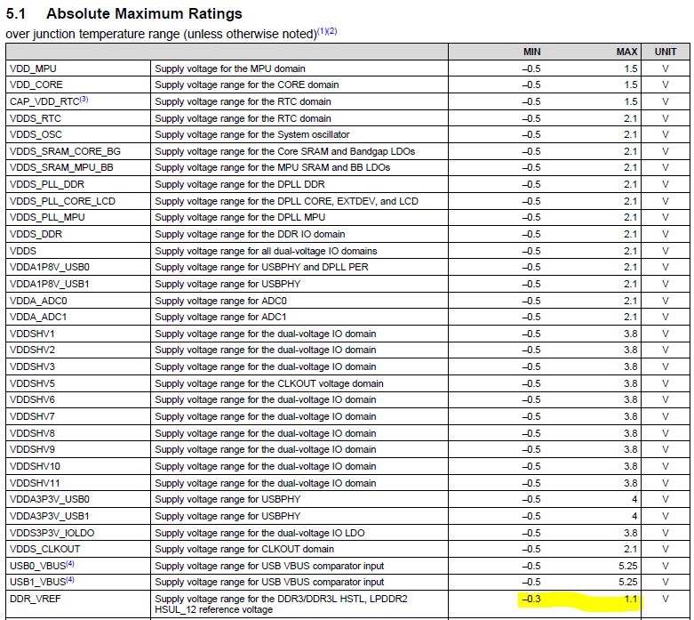

I have a question about the DDR_VREF pin of TMDSEVM437X.
When I turn on the power supply to TMDSEVM437X, voltage will be applied momentarily to about 0.3 V before DDR_VREF completely rises. Is this waveform a problem?
I checked DS and it became below, so I think that there is no problem but I want to know just in case.
