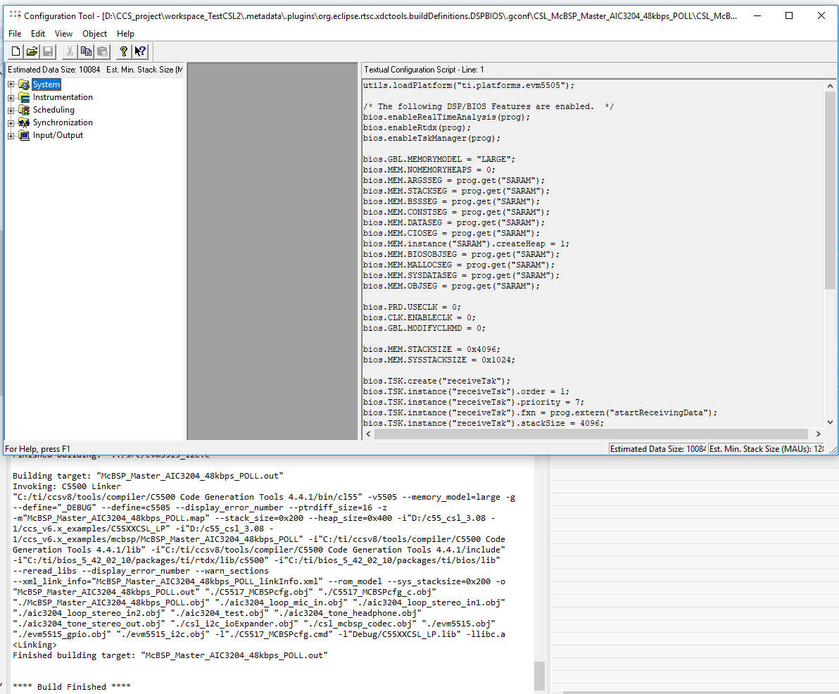

CCS/TMDSEVM5517: Error in opening file.tcf in Code Composer Studio version 8
Part Number: TMDSEVM5517

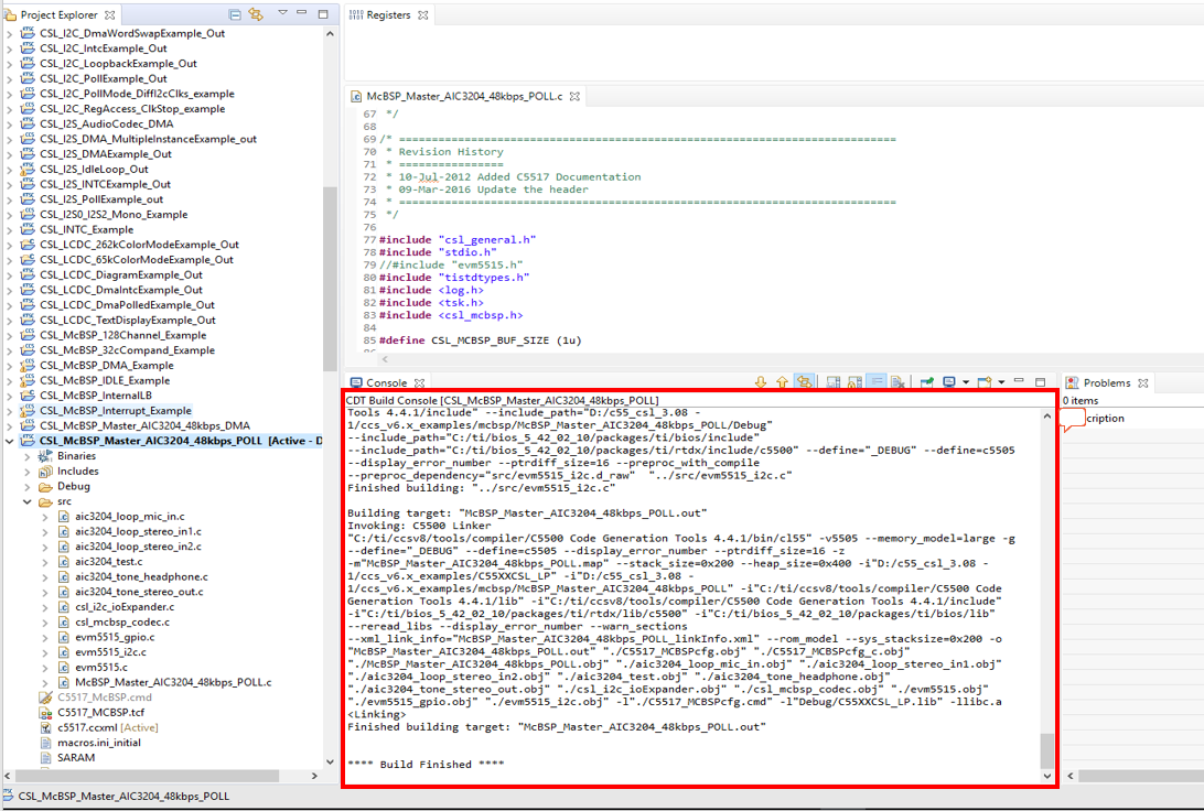

Hello everyone,
I'm Don from Viet Nam. I'm using Code Composer Studio version 8 and kit evm5517.
When I had compiled project CSL_McBSP_Master_AIC3204_48kbps_POLL in Chip Support Library of C55x, I got the error:

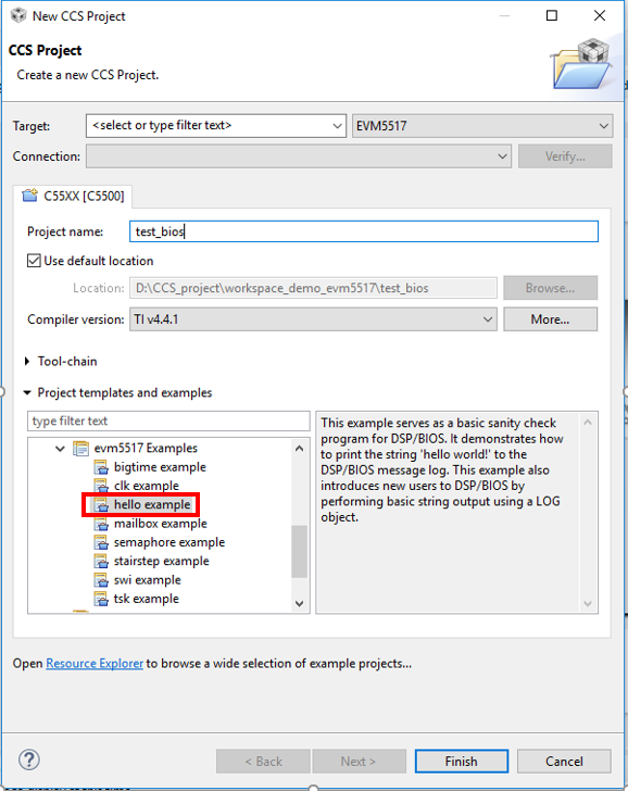

I also created bios examples to test by using step by step below:
File -> New -> CCS Project -> DSP/Bios v5.xx Examples -> evm5517 Examples -> Hello example.
But I have still got the same error to project McBSP_Master_AIC3204_48kbps_POLL when compiling, and I coudn't open file hello.tcf in CCS. The following error showed up when I had tried to open tcf file:

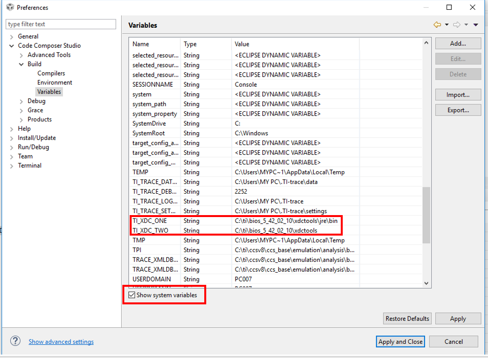

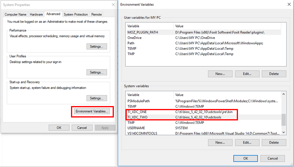

I have followed the instructions of the link: e2e.ti.com/.../422003 , appending the system PATH:
But it doesn't work. The error is still remain.
I have uninstalled CCS v8 and reinstalled CCS v8 again. However, the error has still appeared.
Does anybody know what to do? Please give me the guide to solve this issue.

  • Hi Don,
    Please refer to e2e.ti.com/.../422003
    Todd

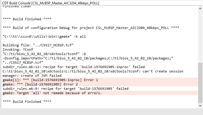

  • Dear Sasha,
    I have followed your instruction:
    I have gotten some debugging information:
    In project CSL_McBSP_Master_AIC3204_48kbps_POLL:
    **** Clean-only build of configuration Debug for project CSL_McBSP_Master_AIC3204_48kbps_POLL ****
    "C:\\ti\\ccsv8\\utils\\bin\\gmake" -k clean
    DEL /F "C5517_MCBSP.cdb" "McBSP_Master_AIC3204_48kbps_POLL.hex" "C5517_MCBSPcfg.cmd" "C5517_MCBSPcfg.s??" "C5517_MCBSPcfg_c.c" "McBSP_Master_AIC3204_48kbps_POLL.out" "C5517_MCBSPcfg.h" "C5517_MCBSPcfg.h??"
    DEL /F "C5517_MCBSPcfg.d"
    DEL /F "C5517_MCBSPcfg.obj" "C5517_MCBSPcfg_c.obj" "McBSP_Master_AIC3204_48kbps_POLL.obj" "aic3204_loop_mic_in.obj" "aic3204_loop_stereo_in1.obj" "aic3204_loop_stereo_in2.obj" "aic3204_test.obj" "aic3204_tone_headphone.obj" "aic3204_tone_stereo_out.obj" "csl_i2c_ioExpander.obj" "csl_mcbsp_codec.obj" "evm5515.obj" "evm5515_gpio.obj" "evm5515_i2c.obj"
    DEL /F "C5517_MCBSPcfg_c.d" "src\McBSP_Master_AIC3204_48kbps_POLL.d" "src\aic3204_loop_mic_in.d" "src\aic3204_loop_stereo_in1.d" "src\aic3204_loop_stereo_in2.d" "src\aic3204_test.d" "src\aic3204_tone_headphone.d" "src\aic3204_tone_stereo_out.d" "src\csl_i2c_ioExpander.d" "src\csl_mcbsp_codec.d" "src\evm5515.d" "src\evm5515_gpio.d" "src\evm5515_i2c.d"
    Could Not Find D:\c55_csl_3.08 - 1\ccs_v6.x_examples\mcbsp\McBSP_Master_AIC3204_48kbps_POLL\Debug\C5517_MCBSP.cdb
    Could Not Find D:\c55_csl_3.08 - 1\ccs_v6.x_examples\mcbsp\McBSP_Master_AIC3204_48kbps_POLL\Debug\C5517_MCBSPcfg.d
    Could Not Find D:\c55_csl_3.08 - 1\ccs_v6.x_examples\mcbsp\McBSP_Master_AIC3204_48kbps_POLL\Debug\C5517_MCBSPcfg.obj
    Could Not Find D:\c55_csl_3.08 - 1\ccs_v6.x_examples\mcbsp\McBSP_Master_AIC3204_48kbps_POLL\Debug\C5517_MCBSPcfg_c.d
    Could Not Find D:\c55_csl_3.08 - 1\ccs_v6.x_examples\mcbsp\McBSP_Master_AIC3204_48kbps_POLL\Debug\src\McBSP_Master_AIC3204_48kbps_POLL.d
    Finished clean
    **** Build Finished ****
    **** Build of configuration Debug for project CSL_McBSP_Master_AIC3204_48kbps_POLL ****
    "C:\\ti\\ccsv8\\utils\\bin\\gmake" -k all
    Building file: "../C5517_MCBSP.tcf"
    Invoking: TConf
    "C:/ti/bios_5_42_02_10/xdctools/tconf" --d -b -Dconfig.importPath="C:/ti/bios_5_42_02_10/packages;" "../C5517_MCBSP.tcf"
    TC - 0: TCF_create(../C5517_MCBSP.tcf, 0x19fed4, 0x19ff04)
    TC - 0: getClassPath(0x19f66c, 0x406010, 0x407f48)
    TC - 0: findFile(js.jar, 0x407f48)
    TC - 0: testing C:\ti\bios_5_42_02_10\xdctools\js.jar ...
    TC - 0: testing C:\ti\bios_5_42_02_10\xdctools\..\lib\js.jar ...
    TC - 0: testing C:\ti\bios_5_42_02_10\xdctools\packages\xdc\shelf\java\js.jar ...
    TC - 0: found C:\ti\bios_5_42_02_10\xdctools\packages\xdc\shelf\java\js.jar
    TC - 0: findFile(config.jar, 0x407f48)
    TC - 0: testing C:\ti\bios_5_42_02_10\xdctools\config.jar ...
    TC - 0: found C:\ti\bios_5_42_02_10\xdctools\config.jar
    TC - 0: findFile(antlr.jar, 0x407f48)
    TC - 0: testing C:\ti\bios_5_42_02_10\xdctools\antlr.jar ...
    TC - 0: testing C:\ti\bios_5_42_02_10\xdctools\..\lib\antlr.jar ...
    TC - 0: testing C:\ti\bios_5_42_02_10\xdctools\packages\xdc\shelf\java\antlr.jar ...
    TC - 0: found C:\ti\bios_5_42_02_10\xdctools\packages\xdc\shelf\java\antlr.jar
    TC - 0: default class path = C:\ti\bios_5_42_02_10\xdctools\packages\xdc\shelf\java\js.jar;C:\ti\bios_5_42_02_10\xdctools\config.jar;C:\ti\bios_5_42_02_10\xdctools\packages\xdc\shelf\java\antlr.jar;
    TC - 0: getLibraryPath(0x29e3771, 0x19fe78)
    TC - 0: default library path = -Djava.library.path=C:\ti\bios_5_42_02_10\xdctools;C:\ti\bios_5_42_02_10\xdctools;C:\ti\bios_5_42_02_10\xdctools\..\bin;.
    TC - 0: findFile(jre\bin\java.exe, 0x407f48)
    TC - 0: testing C:\ti\bios_5_42_02_10\xdctools\jre\bin\java.exe ...
    TC - 0: found C:\ti\bios_5_42_02_10\xdctools\jre\bin\java.exe
    TC - 0: findFile(jre\bin\client\jvm.dll, 0x407f48)
    TC - 0: testing C:\ti\bios_5_42_02_10\xdctools\jre\bin\client\jvm.dll ...
    TC - 0: found C:\ti\bios_5_42_02_10\xdctools\jre\bin\client\jvm.dll
    TC - 0: createVM(0x29e334c, C:\ti\bios_5_42_02_10\xdctools\jre\bin\client\jvm.dll, 0x19fc70)
    TC - 0: JVM option[0] = -Xverify:none
    TC - 0: JVM option[1] = -Dconfig.importPath=C:/ti/bios_5_42_02_10/packages;
    TC - 0: JVM option[2] = -Djava.class.path=C:\ti\bios_5_42_02_10\xdctools\packages\xdc\shelf\java\js.jar;C:\ti\bios_5_42_02_10\xdctools\config.jar;C:\ti\bios_5_42_02_10\xdctools\packages\xdc\shelf\java\antlr.jar;
    TC - 0: JVM option[3] = -Djava.library.path=C:\ti\bios_5_42_02_10\xdctools;C:\ti\bios_5_42_02_10\xdctools;C:\ti\bios_5_42_02_10\xdctools\..\bin;.
    TC - 0: JVM option[4] = -Dconfig.scriptName=../C5517_MCBSP.tcf
    TC - 0: JVM option[5] = -Dconfig.rootDir=C:\ti\bios_5_42_02_10\xdctools
    TC - 0: JVM option[6] = -Dconfig.path=C:\ti\bios_5_42_02_10\xdctools;C:\ti\bios_5_42_02_10\xdctools\..\lib;C:\ti\bios_5_42_02_10\xdctools\packages\xdc\shelf\java;C:\ti\bios_5_42_02_10\xdctools\..\..\ccsv5\eclipse;
    TC - 0: JVM option[7] = -Dconfig.gopts=
    TC - 0: JVM option[8] = vfprintf
    TC - 0: JVM option[9] = exit
    TC - 0: JVM option[10] = abort
    TC - 0: getVMCreateFxn(0x29e334c, C:\ti\bios_5_42_02_10\xdctools\jre\bin\client\jvm.dll)
    GD - 0: GLD_create(C:\ti\bios_5_42_02_10\xdctools\jre\bin\client\jvm.dll)
    TC - 0: Can't load Java VM dll
    TC - 0: TCF_delete(0x29e334c)
    subdir_rules.mk:12: recipe for target 'build-1576691905-inproc' failed
    C:\ti\bios_5_42_02_10\xdctools\C:/ti/bios_5_42_02_10/xdctools/tconf: can't create session manager: create of JVM failed
    gmake[1]: *** [build-1576691905-inproc] Error 1
    gmake: *** [build-1576691905] Error 2
    subdir_rules.mk:9: recipe for target 'build-1576691905' failed
    gmake: Target 'all' not remade because of errors.

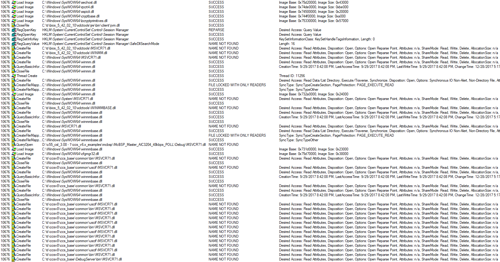

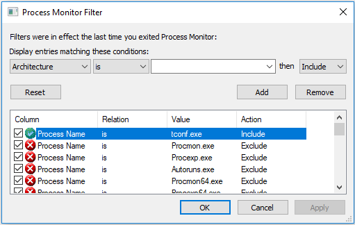

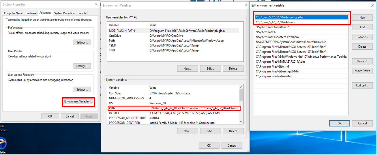

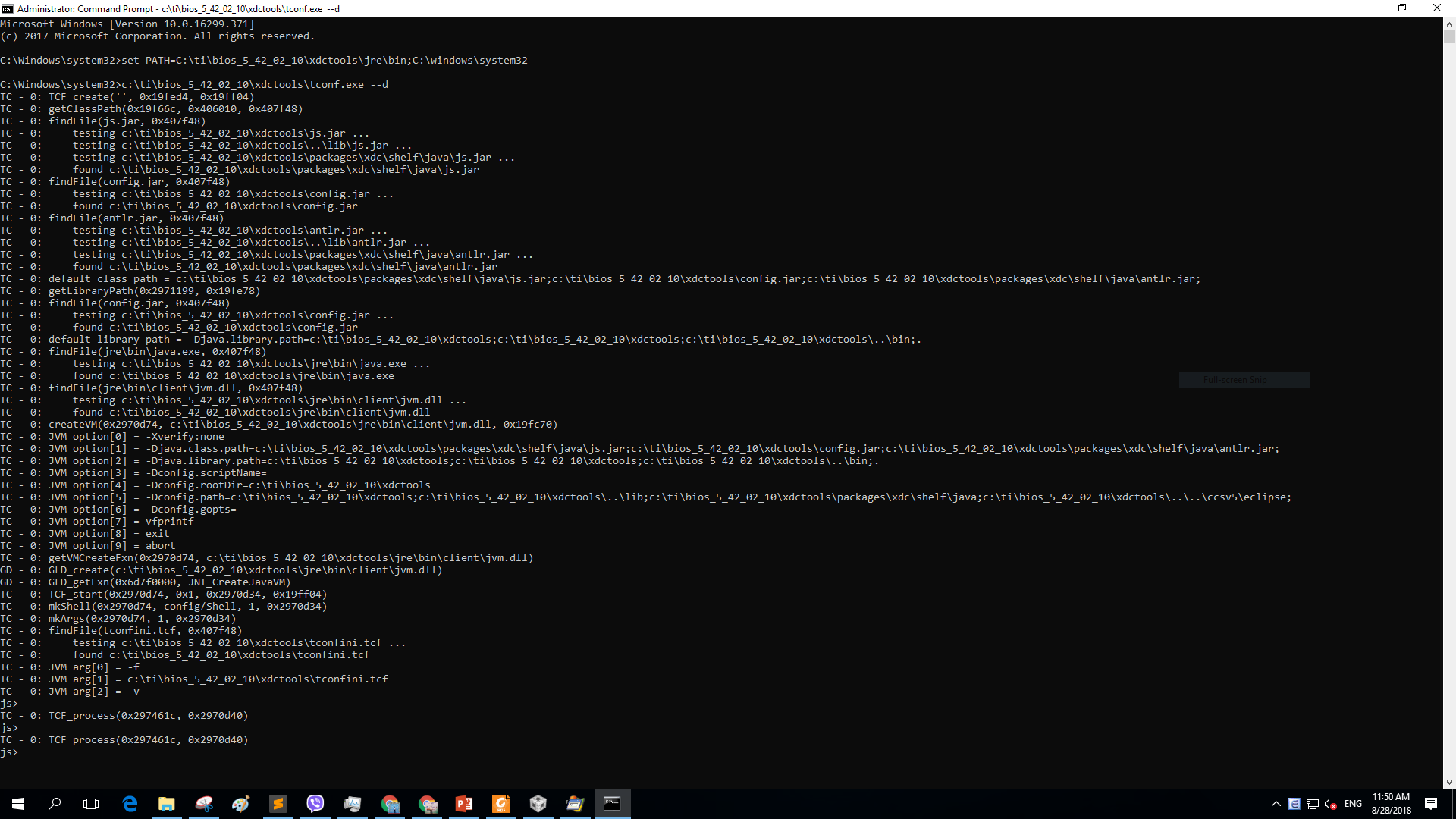

  • Don,
    this points to msvcr71.dll or some other dll not being on the path. The easiest thing to verify that you have a correct path is to open a command line window and then set path:
    $> set PATH=C:\ti\bios_5_42_02_10\xdctools\jre\bin;C:\windows\system32
    and then run tconf
    $> c:\ti\bios_5_42_02_10\xdctools\tconf.exe --d
    If tconf still fails, then it's probably a different DLL and the debugging becomes more involved. I would recommend getting Process Monitor from docs.microsoft.com/.../procmon, and start it. It reports a lot of traffic, but you should go to Filter->Filter... and add a rule "Process Name is tconf.exe then Include". After that, run tconf again, and you should get a long list of events. Somewhere towards the bottom there will be "NAME NOT FOUND" or some similar error status. It will refer to a string under the column "Path". Whatever is listed under Path is the a DLL or another component that is missing.
  • Dear Sasha,
    I have followed your instructions. I've gotten some results:
    I used the ProcessMonitor which you suggestted. Like this:
    Then, I have compiled project CSL_McBSP_Master_AIC3204_48kbps_POLL, the error is still remaining.
    You can see the process monitor log in the attached file:
    Logfile.rar
    What should I do next?
    Thank you so much.

  • The command window output shows that when jre/bin is in the path, tconf is working as expected, so the problem with tconf in CCS8 is that your PATH changes are not seen by CCS. I can't see from the thread what changes you have made previously, but you should adjust your PATH under Environment Variables to include jre/bin, then reboot your PC just in case, and then restart CCS.

    I've also checked in CCS enviroment PATH in CCSv8 by using step by step: Windows -> Preferences -> Code Composer Studio -> Build -> Variables -> Show system variables, two environment path variables can be seen in CCSv8 :
    Based on the list of processor monitor when debugging tconf.exe:
    I decided to copy file msvcr71.dll from C:\ti\bios_5_42_02_10\xdctools\jre\bin into C:\ti\bios_5_42_02_10\xdctools then I compiled project CSL_McBSP_Master_AIC3204_48kbps_POLL  again and it worked. It's so surprising. Here is a result:
    However, this error haven't disappeared yet after trying to open file file.tcf in CCSv8:

  • These two environment variables don't do anything. You have to add jre/bin to PATH as I mentioned in my previous post.
    The project compilation succeeded most likely because makefiles used in the project build add C:\ti\bios_5_42_02_10\xdctools to PATH, but these makefiles are not used when you are opening a TCF script in a graphical environment.
  • Dear Sasha,
    I have followed what you said:
    And it worked. I now open file.tcf in CCSv8. Here is the result:
    Thank you so much.
