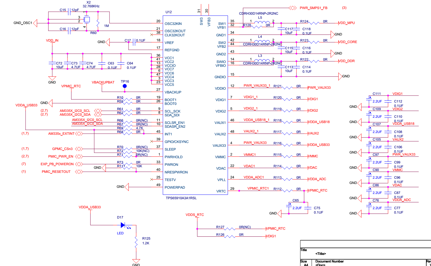

To this point the AM3354 lost its power and u-boot was not able to run further.So generally i suspect it's a PMIC issue?
There is a LED call "D17" on our board which is the indication of VAUX33 output of TPS65910.And i can clearly see that the LED is on for a second or two.Then went off.
The power loss phenomenon happens a lot but do not happen every single time.There are small chances that the power is not lost and u-boot is started normally.
The detailed model of the PMIC is TPS65910A3A1RSL
Here is the schematic of our core board regarding PMIC.

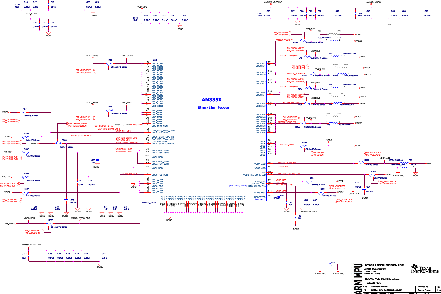

And the way it's connected to AM3354 is:
I checked the I2C0 waveform output .And it seems at least the AM3354 is indeed issueing I2C0 commands to 0x2D address.

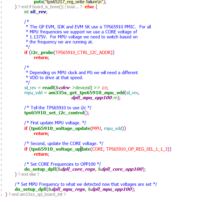

am33xx_spl_board_init() in board\ti\am335x\board.c which contains a number of initial sequence for tps65910 is also done without exiting unexpectedly.
here:
the power up sequence works well in u-boot-2011.But the initialization part is closed source and packed in a library.So i can't see how the old u-boot-2011 got the PMIC properly initialized.
My guess would be that there're some differences between our own board (schematic or tps65910 model suffix? ) and the TI  AM335x GP EVM?
That the init code for AM335x GP EVM won't work for us?
Can you guys tell me where to start debugging this? like measuring the voltage output or do something else.
Right now i really don't know where i can start from...

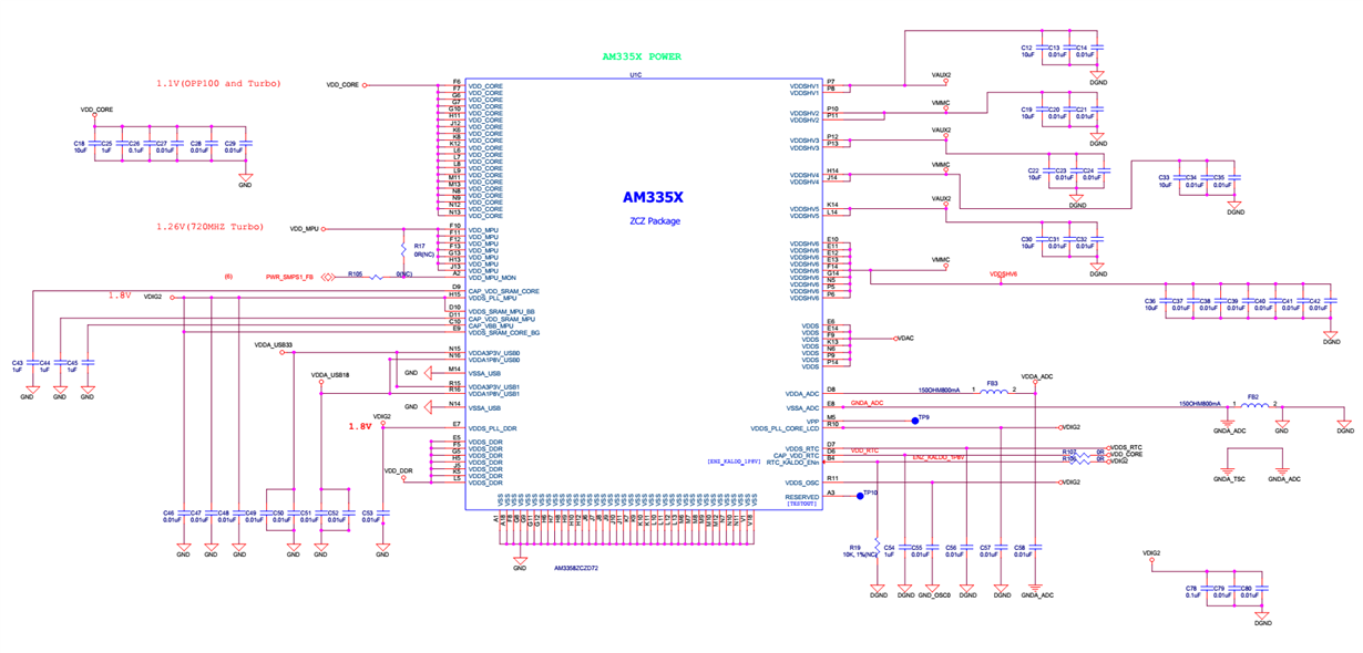

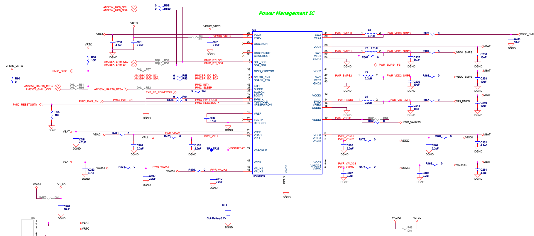

for your convenience i'm also attaching the schematic of "AM335x GP EVM"
