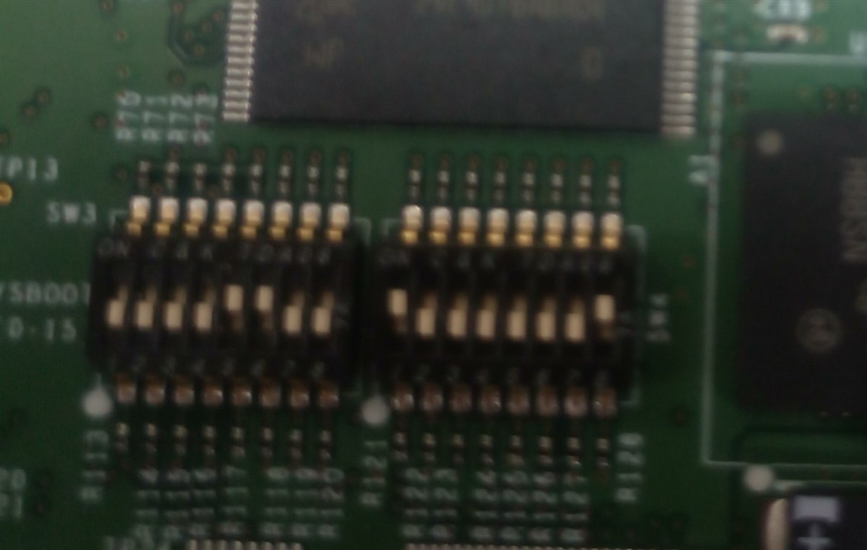

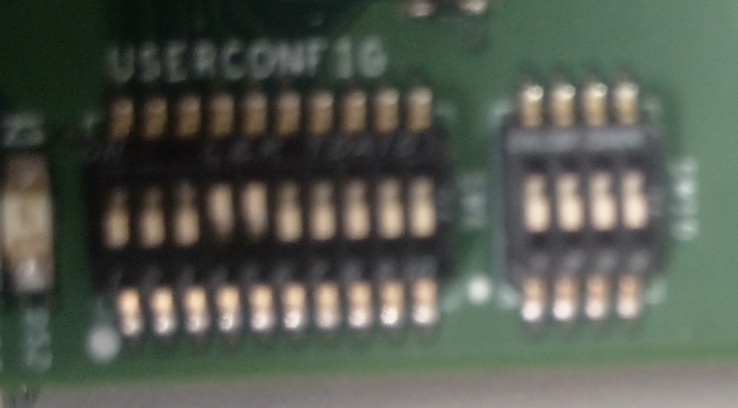

  • Hi Jack,
    can you check that your SYSBOOT is configured correctly for SD boot as described in VisionSDK_Linux_UserGuide.pdf chapter"4.2 Preparing SD card & Boot"?
    Yordan
  • Hi Jack,
    Could you also please confirm, that you changed uenv.txt file to pick correct dtb file
    i.e from fdtfile=dra7-evm-infoadas.dtb to fdtfile=dra76-evm-infoadas.dtb
    Surya
  • Hi Yordan Kamenov,
    we set SYSBOOT as guide's description. sd sw3 00001100 10000001
    we prepare sd card follow chapter 4.2.

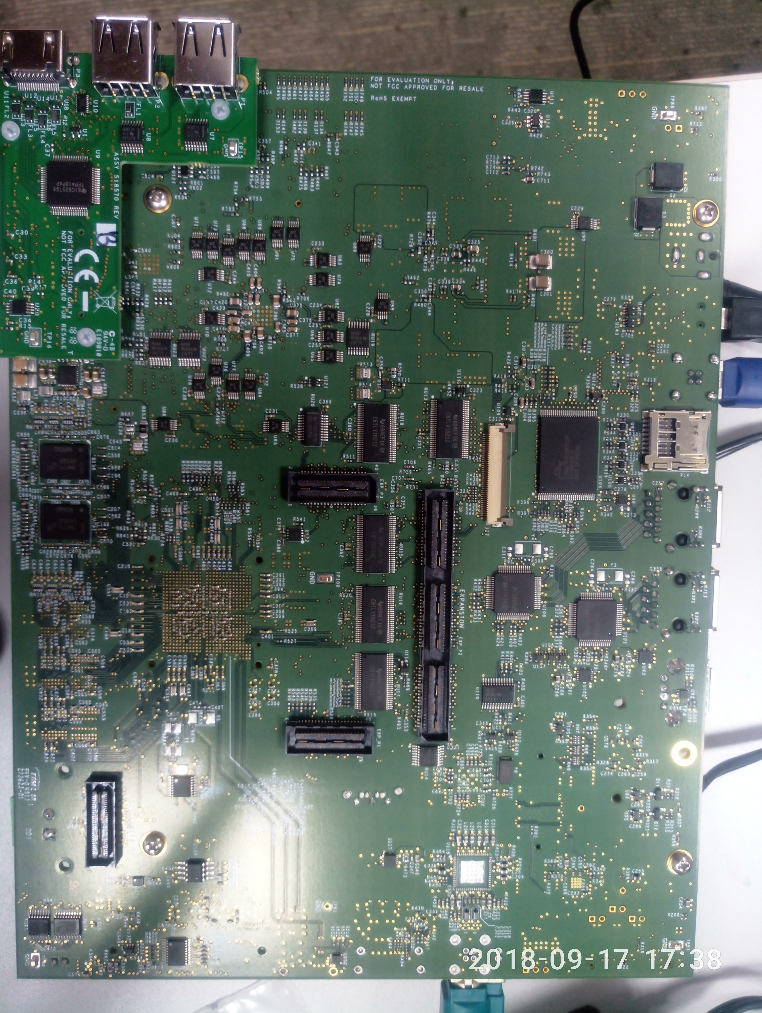

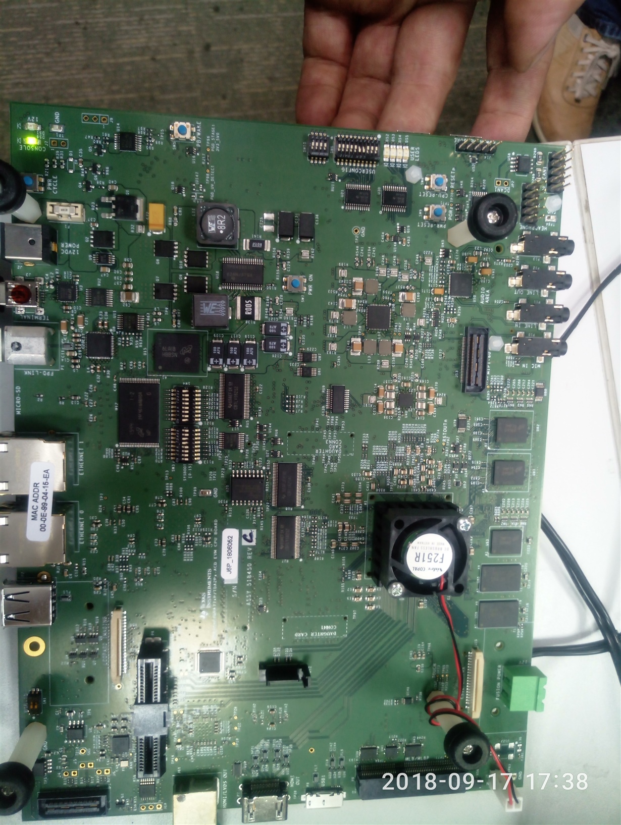

  • Hi Jack,
    There is no reset issue as far as SoC is concerned.
    Can you take a picture of the EVM and share.
    Rishabh
  • Hi Rishabh,
    Do you want EVM board picture?
    upper are our received EVM board pictures.
  • Hi Jack,
    Switch settings seem fine.
    It is possible that there were issues with creating the card due to which reset is being generated.
    Let us focus on BIOS for now and try to root cause the problem. Can you please do the below:
