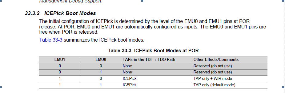

I wants to ask if emu0/emu1 is necessary to connect between emulator and Soc.
Our customer try to use TI 14-pin JTAG connector, but let emu0/emu1 unconnected.
when they using XDS560V2 STM emulator+CCS8.1 to debug on their board, they found that they can do "Test connection" action successfully. But they can not connect to MPU.
as TRM shown, emu0/emu1 should be pull up when debug.
Would you please help me to check if emu0/emu1 must be pull up with external resistor? Is there any way to solve this problem without making new board?

  • Yong, these pins are already pulled up internally at reset, see CTRL_CORE_PAD_EMU0 and CTRL_CORE_PAD_EMU1 registers. What error message do they get when trying to connect to the MPU? Are the gel scripts initializing the core successfully?

    This test will use blocks of 64 32-bit words.
    This test will be applied just once.
    Do a test using 0xFFFFFFFF.
    Scan tests: 1, skipped: 0, failed: 0
    Do a test using 0x00000000.
    Scan tests: 2, skipped: 0, failed: 0
    Do a test using 0xFE03E0E2.
    Scan tests: 3, skipped: 0, failed: 0
    Do a test using 0x01FC1F1D.
    Scan tests: 4, skipped: 0, failed: 0
    Do a test using 0x5533CCAA.
    Scan tests: 5, skipped: 0, failed: 0
    Do a test using 0xAACC3355.
    Scan tests: 6, skipped: 0, failed: 0
    All of the values were scanned correctly.
    The JTAG DR Integrity scan-test has succeeded.
    [End: Spectrum Digital XDS560V2 STM USB Emulator_0]
    Thanks a lot
    yong
    Thanks for providing the log results. Looks like the connection stress test passes fine. However the gels are crasing not able to read a device ID register.
    1. Are you booting an OS while trying to JTAG connect?
    2. Can you make sure you are using the latest device support package? processors.wiki.ti.com/.../Device_support_files
    thanks,
    Alex
  • Hello Yong,
    It's been a few days, can you answer my questions, let's solve this issues. Or if you already fixed it, please mark this thread done.
    thanks,
    Alex
