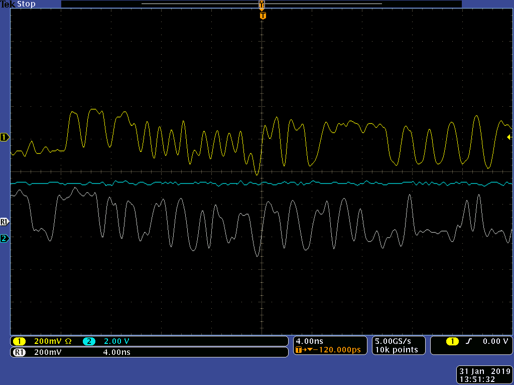

I'm currently developing on the TDA2PXEVM with fusion application board and a custom cascade radar board with four AWR1243 chips. I am using CCS studio version 8.1.0.00011 and Vision SDK version 3.04.
With some modifications to the radar chip control logic, I was able to run the camera radar capture display usecase with a single radar chip on my custom board and a D3 IMX390 camera. However, when I try to run the radar capture only usecase, I get an "i2c4 transfer to slave address 0x74 failed" error, and I can't run the cascade radar capture usecase because I don't have access to the TDA2xx processing board and cascade radar board required.
Currently, I am creating a custom usecase for interfacing with the radar chips on my custom radar board, based on the existing radar capture only, camera radar capture display, cascade radar capture usecases. However, when I try to run this usecase, I get the i2c4 transfer error for the addresses of the 4 serializers, 0x74, 0x76, 0x78, and 0x7a. The custom radar board is set up the same way as for running the camera radar capture display usecase, except with the 4 radar chips connected instead of 1 radar and 1 camera.
How do I need to modify my usecase code and/or the underlying configuration code in order for the SDK to recognize the 4 serializers and sensors on my custom board? Attached are the files for my custom usecase.

  • Hi Stanley,
    Below is the scope output when probing the FPD links, where the yellow waveform is the cascade use case and the white waveform is the single use case.
    Is there some way to tell whether the cascade radar data is valid?

  • Hi Richard,
    You can verify the radar data by using test mode from Radar. This can be enabled by using ChainsCommon_ar12xxEnableTestSource() API.
    This can be enabled by uncommenting "#define ENABLE_TEST_SOURCE" in ~/vision_sdk/apps/src/rtos/radar/src/common/chains_common_ar12xx.c.
    You can refer to ~/ti_components/drivers/pdk_xx_xx_xx/packages/ti/drv/vps/unit_test/cascadeRadarUt/src/CascadeRadar_main.c to see how the data is verified in CascadeRadar_vipCbFxn().
    However, this method can only be used if the data is actually received by TDA2P. Based on the discussion earlier, it sounds like TDA2P didn't even receive the data from CSI-2 port.
    As for UB960 registers, you have to access via I2C commands.
    Stanley
