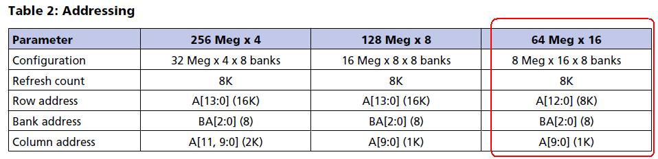

    Where did u see DDR2 32-bit address bus for DM6437? There are only 13 address lines (DDR_A[0:12]). Look at page Page 42 in DM6437 data sheet (http://www.ti.com/lit/gpn/tms320dm6437). With 13-bit addess bus and 3 Bank Select Outputs (BA[2:0]), the DM6437 can support max 256MB DDR2 memory space, as mentioned in the data sheet memory map.
    The above math you did (2^no.of address lines) applies to linear memories. The same math doesn't apply to DDR2 memories. DDR2 meries use bank, row, column addresses.
    Consider the following example, where two 128MB DDR2 parts (that is 1Gbit memories) are connected to DM6437 (assume the same connections as in DM6437 EVM schematic, Page 14 (http://c6000.spectrumdigital.com/evmdm6437/reve/files/EVMDM6437_Schematic.pdf).
    Assume two 1Gb DDR2 parts: MT47H64M16 (8 Meg x 16 x 8 banks). As per the Addressing mentioned on Page 2 of MT47H64M16's data sheet (attached here for quick reference), BA[2:0] bits are used for Bank selection and address bits DDR_A[0:12] are used for row/column section. So, with 3-Bank select bits and 13-address bits, you can access (max) these two 16-bit 128MB memories (i.e. 128MB *2 = 256MB total).
    I hope this helps you to understand.
    Regards, Srirami.

    But I still need to confirm one thing: For the 1Gbit 64M x 16 micron memory example you gave, since there are only 13 wires, does 13-bit row address and 10-bit column address needs to be send in two times?
    Zheng
  • Yes, they are transmitted in two different clock cycles.  This is a fundamental operation of synchronous DRAM type devices.  First a Row is activated during a RAS cycle and then specific Column addresses are used to access data, ie. CAS cycles.
