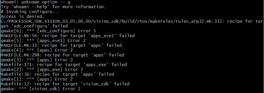

I have been developing on Vision and Radar SDKs, versions 3.04 and 3.05, for a few months. Recently I had to take a several week break from working on these SDKs, but on returning, I am finding that I can no longer compile any of the SDKs, they all give me the same error message:
The only modifications to the PC have been windows updates. Why would I no longer be able to compile SDKs that compiled without any errors several weeks ago?

  • Hi Richard,
    Can you clean using "rm -rf binaries" and then try the build?
    Rishabh
  • and also rm -rf links_fw\include\config.
    it seems you are giving recipe for the target, for which it is already defined.
    Brijesh

  • Hi Rishabh/Brijesh,
    I have tried both "rm -rf binaries" and "rm -rf links_fw\include\config". However, the error persists.
    What else could be the problem?
    Richard
  • Hi Richard,
    Can you run "which gmake" and check if gmake is pointing to XDC?
    Rishabh
  • Hi Rishabh,
    I have verified that gmake is pointing to XDC.
    Richard
  • Hi Richard,
    What is the output of "gmake showconfig"?
    Are you using git bash or command prompt?
    Rishabh

    I have been using command prompt. I just tried using git bash, the error seems to have gone away, I will continue using git bash for now.
