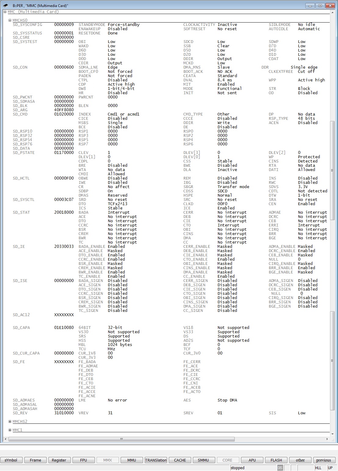

Now the problem is, after sending the comand CMD1 the SD_Register of the eMMCs CTO and ERRI are set and the MMCs are not have any response to the CPU.

    Never the less, as you can read from Dirk, the eMMC is not responding. We attach on register level to communicate with the eMMC.
    After a lucky constellation we found out, with a connection from MMC1.CLK to MMC0.CLK (with PinMux0) the eMMC is working fine.
