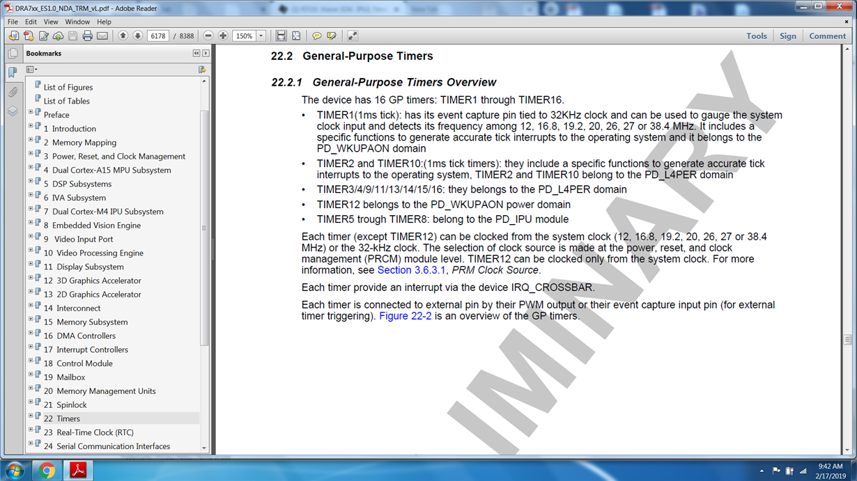

  • Gokul
    I am not sure timer 16 is there for TDA2Ex SoC, please double check (TRM)
    BTW, why are you changing from DM Timer 12 to 16 again? I guess you were trying to change from Timer 2 to 12 last time?

  • Gokul
    No, timer 12 also not used, I have used below ones for TDA2xx
    Timer ID PRCM from Functionality CPU where it used
    DM Timer-5 Linux MLO Bios Timer Tick DSP1 - 2
    DM Timer-6 Linux MLO Timestamp Provider DSP1 - 2
    DM Timer-13 Linux MLO Bios Timer Tick EVE1-4
    DM Timer-14 Linux MLO Timestamp Provider EVE1-4
    DM Timer-9 Linux MLO Bios Timer Tick IPU1 Sub System
    DM Timer-11 Linux MLO Timestamp Provider IPU1 Sub System
    DM Timer-9 Linux MLO Bios Timer Tick IPU2 Sub System
    DM Timer-11 Linux MLO Timestamp Provider IPU2 Sub System
    regards, Shiju
