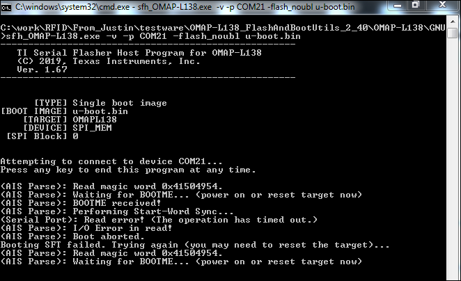

Hi Team,
The bootloader on our custom boards using OMAPL138 are corrupted.
We are trying to bring-up the customized (OMAPL138)  board in where the u-boot.bin(bootloader) was corrupted, we have configured board boot-mode to UART1.
Have connected the customised (OMAPL138)  board to TERATERM COM1 with baud rate 115200, the expected  BOOTME message  pops-up upon POWER-ON the board.
Upon Flashing u-boot.bin using the  sfh  utility  from TI OMAP-L138_FlashAndBootUtils_2_40 we are seeing  errors attached . Please share your comments on this.
